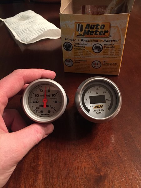

    I put mine in last week. AFR is doing great, but the boost gauge has a bad cable going from gauge to sensor. Speedhut is sending a new one should be here thursday.

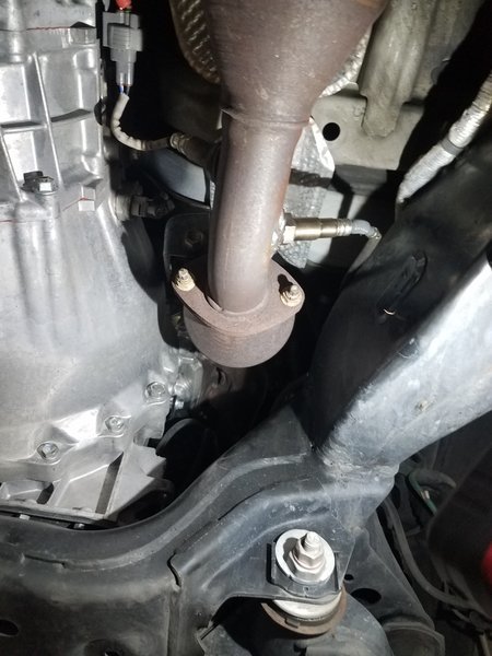

    Is everyone running a single AFR sensor? If so, where did you all mount it? I only know of loginfailed, who uses 2 AFR widebands, one for each manifold.

    After Y-pipe. Slightly skewed but should be good to go.

    Yup after the y pipe.

    I was gonna ask where people are putting them. I was just gonna run one bank. But would like to get it after the y pipe.

    I have one AFR after the y pipe. It reads .2-.3 leaner roughly.

    I went with one on each manifold just to have a more accurate complete picture of what's going on.
    Before the cat is more accurate, but if you only do one side you're only getting half of the picture. A single sensor in the y-pipe gets you the whole picture but less accuracy.

    Mounted mine between the first and second cat on the passenger side. AFR reads 14.7 on the dot on the passenger side at least. Good enough for me.

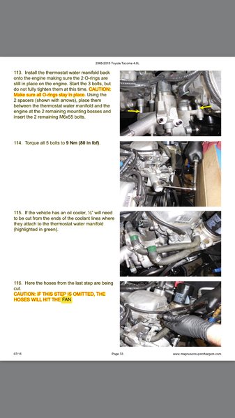

    So my fan is barely rubbing against the coolant hose that goes to the water thermostat housing.... any ideas for a fix without having to remove the hose and drain all the coolant again? Maybe trimming fan blades just a little?

    I think you're supposed to trim that hose, right? I vaguely remember something in the install manual saying if you don't trim this hose it will hit the fan.

    Yea I did. I trimmed like 2.5 inches off that thing but it's still barely rubbing. It clears just fine when it's at idle but when I push the accelerator it touches juuuuuust a littl

    Can you trim it a bit more? Or is there nothing left to trim?

    I can but I'll have to do it without removing the hose from the male fitting so that I don't have to drain the coolant again.

    That sounds like the best option. Just move the clamp, slice a little off and push it on some more then put the clamp back. Might wait till it cooled off though! Lol
