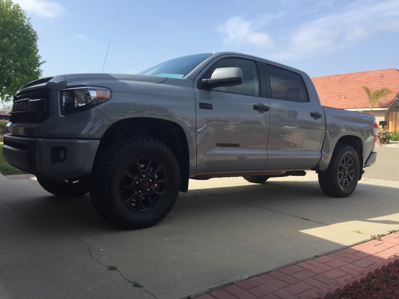

    Truck finally came in yesterday. New tires already mounted. Told you guys I would post it up when it came in.
    Thanks again for everyone's help along the supercharger journey!!!

    Best color!! Great choice
    tacomavoyager likes this.

    Good looking truck.
    tacomavoyager[QUOTED] likes this.
