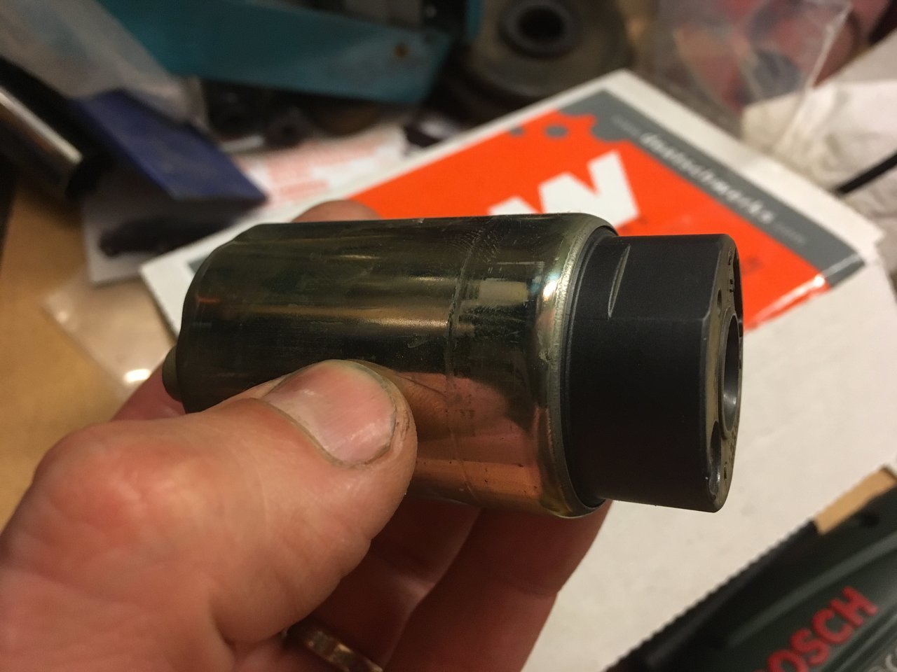

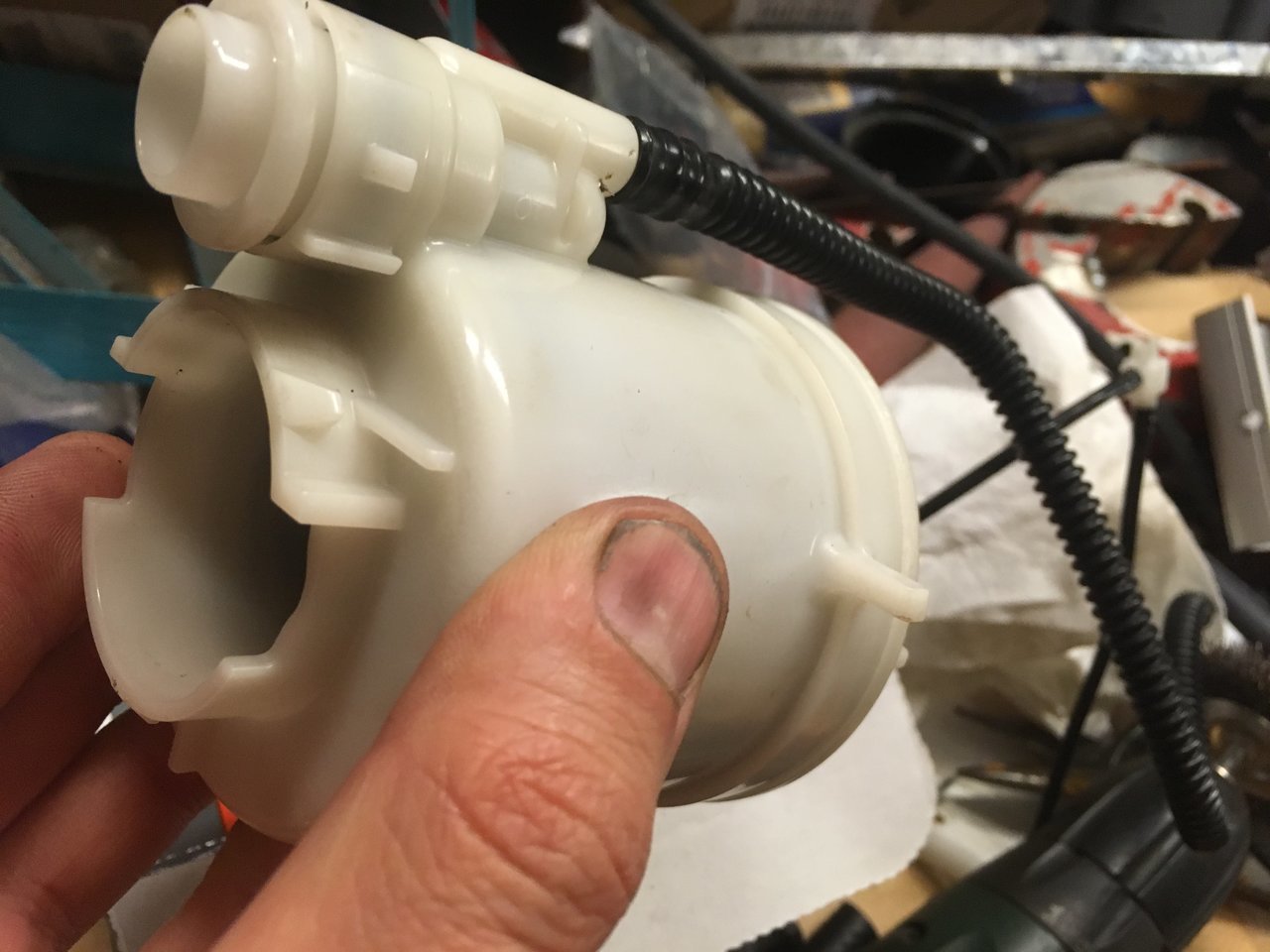

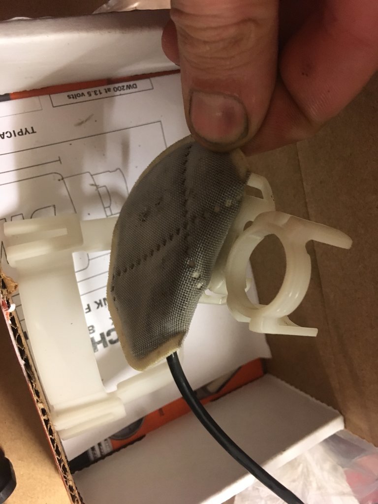

    #4735
    FinnJ
    FinnJ Well-Known Member
    Sep 22, 2016
    #197981
    688
    Finland
    2007 FJ Cruiser 6M/T
    TRD SC, UCON, CNG conversion, RC 6" (lifted 4"/3" air suspension) w/FOX 2.5, 315/70R17 Duratracs, RECARO seats, etc.
    This is the OEM pump:
    This is the (one and only?) OEM fuel filter:
    Then what is this?
    I think the flat one is a pre-filter and that plastic barrel-shaped thing is a main filter.

  16. Aug 13, 2017 at 4:23 PM
    #4736
    inwood customs
    inwood customs Roaming potato
    Sep 11, 2016
    #197024
    4,719
    Dave
    2006 v6 potato bugTuRD
    K&n, flowmaster, plastidip, chipped, hids, daves
    Pretty sure torspd said the same thing.
    Sock is a prefilter type deal and the housing had some integrated filter inside.
    Droptopfox likes this.
  17. Aug 13, 2017 at 9:48 PM
    #4737
    VolcomTacoma
    VolcomTacoma Well-Known Member
    May 25, 2011
    #57205
    20,617
    Jeff
    NorCal
    2015 TRD Sport 4x4 6 Speed Supercharged
    Front- Camburg 4x4 Long Travel 2.5" King Coilovers 2.5" King Triple Bypasses Wheelers Superbumps Rear- DMZ SUA 16" 3.0 King Triple Bypasses 3" 2.0 Fox bumps Wheels and Tires- 295/75/16 Toyo ATII XTREME SCS SR8 Dark Matte Bronze 16" Lighting- (2) 30" Combo light bars (4) Iggycorp diffused pods Tepui Ayer TRD Supercharger URD Mark III 3" Exhaust URD 4x4 Y Pipe URD CAI URD 2.85 Stealth Pulley Hurst Core Shifter with Hurst T URD Stage 3 clutch URD Lightweight flywheel URD Throw out bearing upgrade AEM Wideband AFR Gauge Speedhut Boost Gauge Craven Speed Flex Pod mount Weathertech Floor Liners BAMF Sliders Ultragauge sPod SE ARB CKMTA12 Hella Supertone horns Relentless Tailgate Reinforcement
    Huh, I stand corrected then! Didn't really look at all that. Well, anyone with 50k+ miles might want to think about changing out their fuel pumps, or at least the sock and inner filter, we know gas is pretty shitty sometimes, so all that grit builds up.
    Skootter14 likes this.
