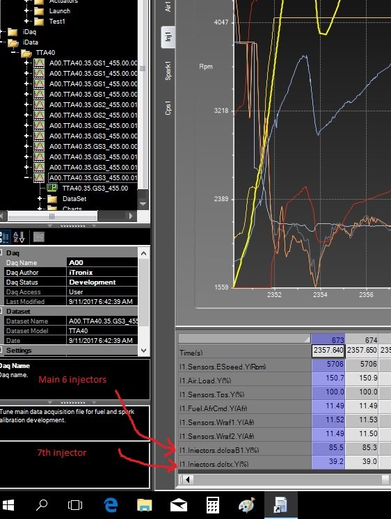

    Hey mr login,
    Which parameters shows the injectors on the data log ?

    Look at the Inj tab toward the bottom. I believe it's dctxinj or something like that. I'm not at my computer at the moment.

    Got it !
    Looks like I'm at 68% / 30%. Installing 2.55 pulley tonight.

    A little visual aid for others to see where injector duty cycle is located:

    That would put you around 380, not too shabby. I wouldn't be surprised if you were making even more than that, considering all the things you have done so far. At 85% duty cycle on your injectors that seems a little high do you think you should upgrade? I could be wrong but I thought I read that the injectors are pretty much topped out at 80%. Loving your setup, I would love to get ucon but for all my other mods I have planned it's a little too expensive right now. Especially since I would have to get a fresh ecu to utilize it's full potential.

    The industry pretty much agrees that 80% is max D.C. I am considering larger injectors. Not because I'm planning to do anything more to increase power, but just for a little breathing room. Most of the time I'm not running WOT to redline so they only get that high on occasion when my right foot is feeling frisky. :D

    But if you look at the numbers on mine, the 7th is already at 40%. That one injector can't do much more by itself. One injector vs six it would be at 80% in no time.
    My thinking is that you want the main six to do all the work and the 7th to add just enough to do the cooling/sealing job.
