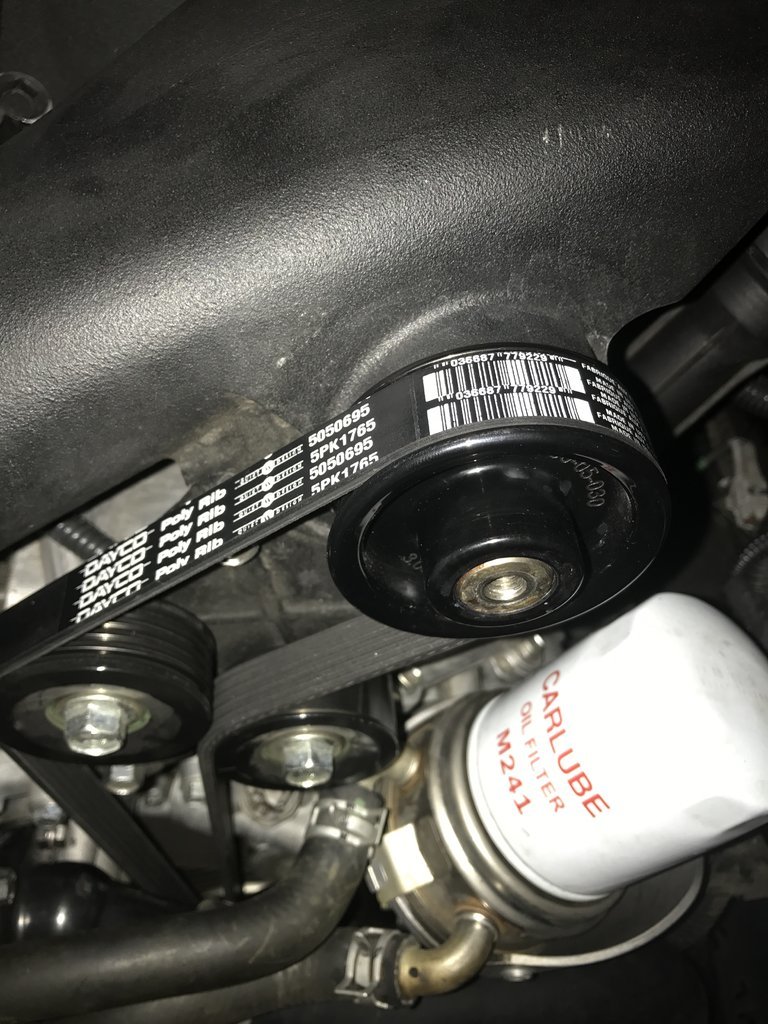

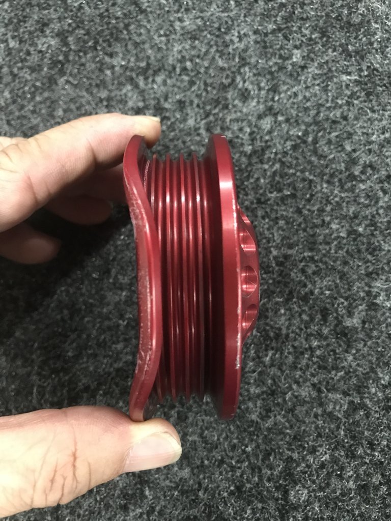

    Amateur mistake .. didn't wait for the engine to cool completely. The stock pulley came off so much easier tho. Instructions said to let the engine cool overnight which I read afterwards :facepalm:.
    But I think it would have bent anyways .. that particular pulley is aluminum.

    If it's that sensitive to the engine heat, wouldn't it have warped anyway after being installed and running at operating temp? Crazy

    No. :confused: Maybe you are not familiar with the changing
    procedure/shrink fitting.

    5 hrs later ..

    That's about how my 2.85" pulley looked. The aftermarket pulleys fit tighter than the stock pulley does.
