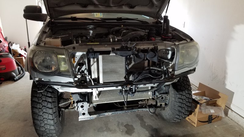

    Also for those installing on their own. Do yourself a favor. Remove the grill as step one. You will thank me later.

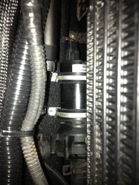

    If you have a pelfreybilt front bumper your pump needs to be relocated. This where I mounted mine.

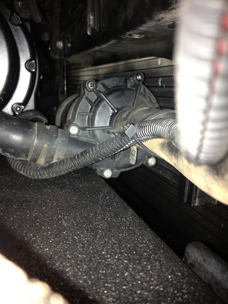

    I found this awhile back don't know if it helps but

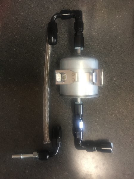

    Here's my proposed setup for the fuel filter. Tank is to the left, engine to the right. That's a lot of Russell fittings.
