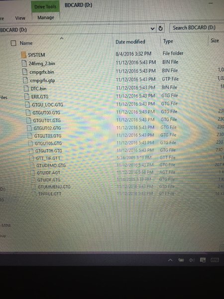

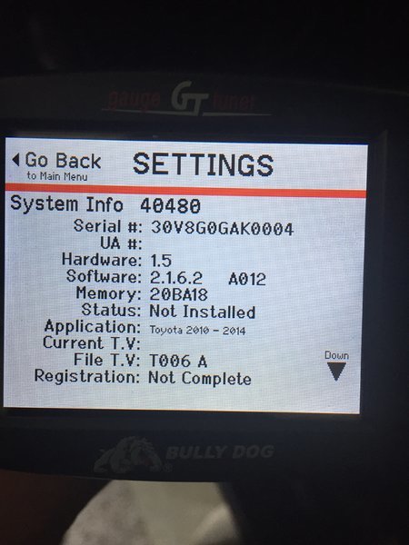

    Look at the settings menu I think the tune is listed as the T.V file. Mine says T006 A

    Maybe the different tunes are T001 T002.. etc

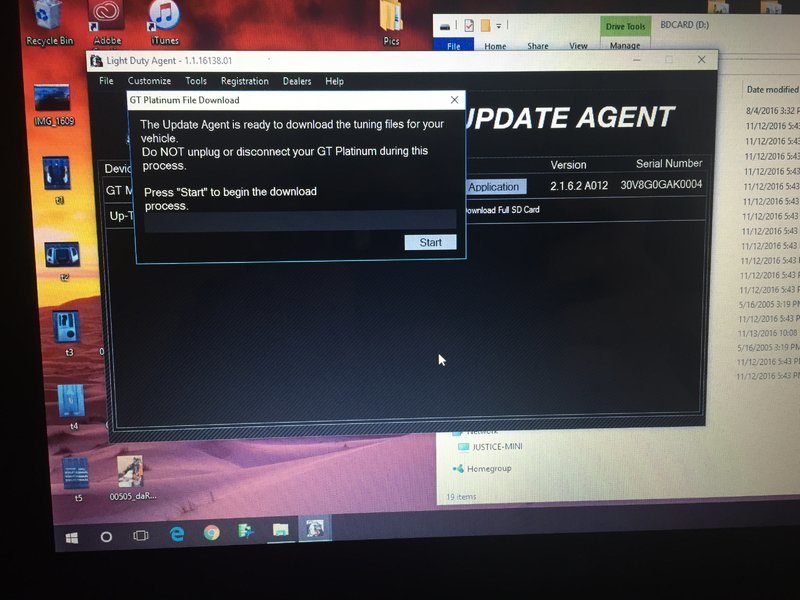

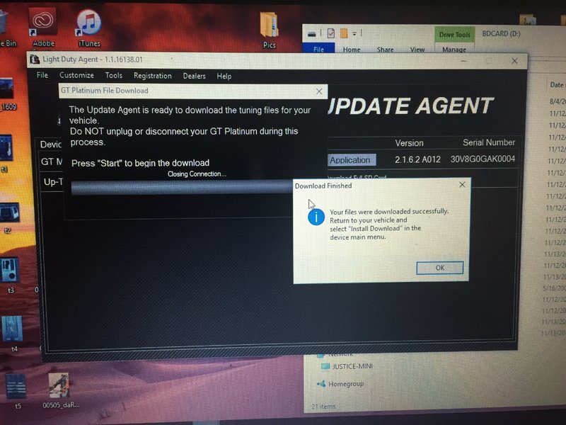

    What worked for me was inserting SD card into tuner then plug it into computer using USB. Run the agent select update. After it updates unplug USB remove and reinsert SD and close program. The adaptor wasn't working for me. Plug into computer then open up update agent and it finally recognized the SD card. I had to close and open the update agent a few times and remove and reinsert SD card. After that you should be able to pull down menu and select your vehicle. I also plugged it into computer exited USB mode and was able to fully reboot the handheld on the menu screen. If you do that just make sure you have the right model number from the packaging on the tuner. It will ask for it.

    @tacomavoyager what does yours say in the settings menu for the T.V file?

    Ok not sure what I did earlier, but apparently it didn't download what needed to download. Now it is giving me the warnings of making sure I am attached to a battery charger and whatnot. When I select continue, it says that my battery needs to be at least 12.1V, but I am only at 12V and it won't continue. I am beginning to hate BD.

    Mine has the same gtummenu. Don't now if that needed to be changed on yours. FYI

    Well I got it to work! Just needed a decent charger. Id definitely recommend a 15amp minimum charger. Now it's time to start tearing this thing apart!

    Ok I just did the uninstall feature and put the truck back to stock. Now I'm redownloaing all the tunes from the update agent.
    Initially I only selected to download 2.85 pulley and stock shift points. This time I'm downloading tune A (2.85/performance shift points) tune B (2.85/stock shift points) tune C (3.00/performance shift points)
    It's a shame the BD won't display the actual tune (i.e. 2.85 w/ performance shift points) vs saying tune A, B or C.

    So T006A shows no matter what tune I install. So the BD does not show what tune your truck "currently" has. You just have to remember what tune you had. Time for a test drive.
