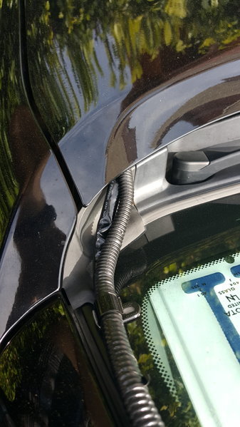

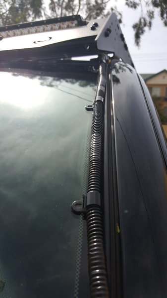

    Hey guys, are there any write ups on wiring a light bar for this? I know how it mounts, just not sure where to run the wiring. I really don't want to drill to make it work.
    Can someone point me in the right direction? Thanks

    Just run it directly down the windshield, no need to drill 20160320_144641.jpg 20160320_144650.jpg

    Is there any other way to run the wire that it's hidden?

    You can run it down the edge of the windshield so that it's "hidden" in the gap, you can drill through the roof and run it through the A pillar, or run it down the back of the cab and under the body. Not many ways to really hide it without drilling.

    exactly, You can kind of jam it in that gap with out the wiring loom and its relatively hidden.

    I bucked up and drilled the roof. Wasn't that bad. Headliner came down pretty easy too. Just use a weatherproofing nipple.
