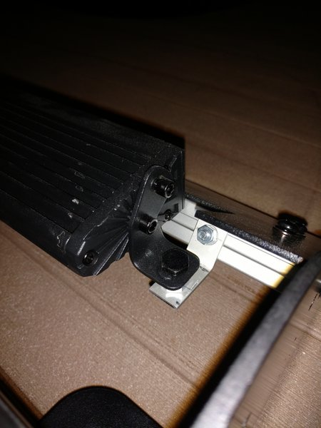

    Here ya go boys...
    I used washers on the bottom of the mount to get the bar up to the correct height

    So is the weight of the light all resting on a free piece of aluminum? You don't think that will eventually move the projection by going over bumps and what not? I would think you'd need another support screw into the first crossbar due to the weight of the light bar

    I've tried to jiggle it around but with lock washers and tightening it's not going anywhere. There isn't much unsupported aluminum that the light is sitting on so I'm not worried about movement from the aluminum bending either. You can use a setup like the other guy where he makes a bracket that attaches behind the light bar too if you're worried about it

    So is your light lower in height than the first crossbar? I'm guessing you placed your fairing on the bottom two holes?

    I did put my fairing on the bottom two holes, yes. It's definitely lower than the first crossbar which is what I was going for. No worries about hitting it when I carry stuff

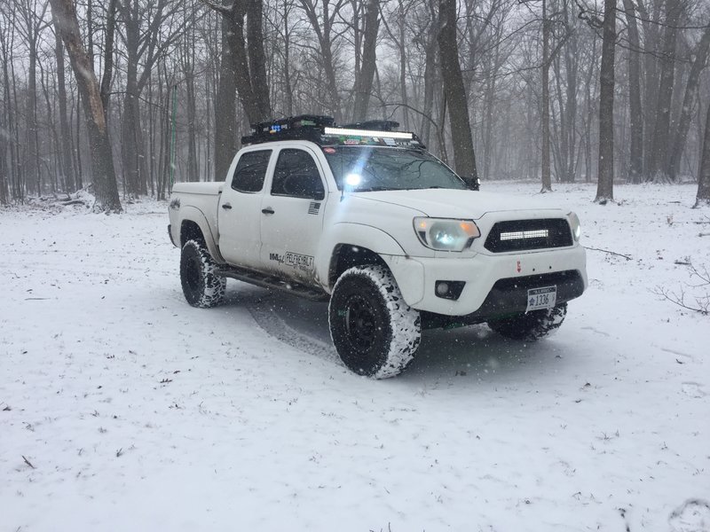

    Never had any wind problems and I have no foam. Just all the way down and a 40" led bar. Probably helps to crank the music haha
