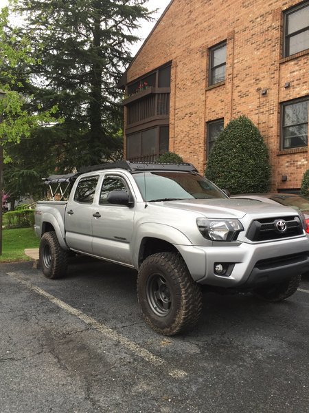

    That looks sick! Just needs some blacked out retrofits and you're golden!

    Thanks man! Call me crazy, but I kind of like the factory headlights

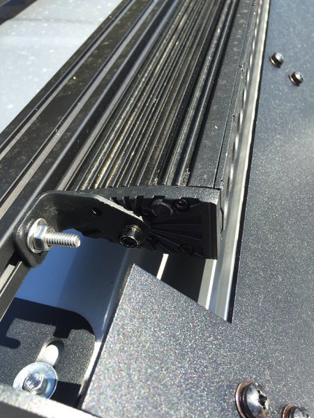

    I used the brackets it came with and mounted it to the first crossbar and not the wind fairing. The screws on the light absolutely suck ass. It was a pain trying to get them threaded into the light w the lock washer. I'll take a pick of how I mounted in a bit and I'll get an output pic later tonight. And thanks!!

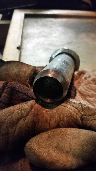

    20160404_135356.jpg For anyone installing and want to reuse the rubber strip, I made this "hole punch" myself out of a piece of 3/4 Id pipe and it worked great to punch the holes.
    Didn't cost anything I had it at home plus took it to the grinder to sharpen then I used a finish stone like you sharpen a knife with to finish the edge.
    About 1/2 hrs of time and I didn't have to buy a bunch of punches I would never use.
    The other end had a hole drilled in the cap, so once I hit the cap with a hammer I could push out the cut piece of rubber.

    3/4 inner diamater? What's the outer diameter? What kind of pipe is it?

    It tapers from 3/4 to whatever the bevel is, not really sure.
    But it cuts so close to 3/4 it's near perfect.
    This is the kind of pipe they use to run natural gas, only a few bucks if you need to buy.

    The Pipe punch I used above worked as well, I used a dremel to cut off the bottom parts of the seal and get the metal out, then punched through the rest. Mine was 3/4 right on, as in the I had to stretch it to fit the spacers through. It rained over night and every thing is dry.
