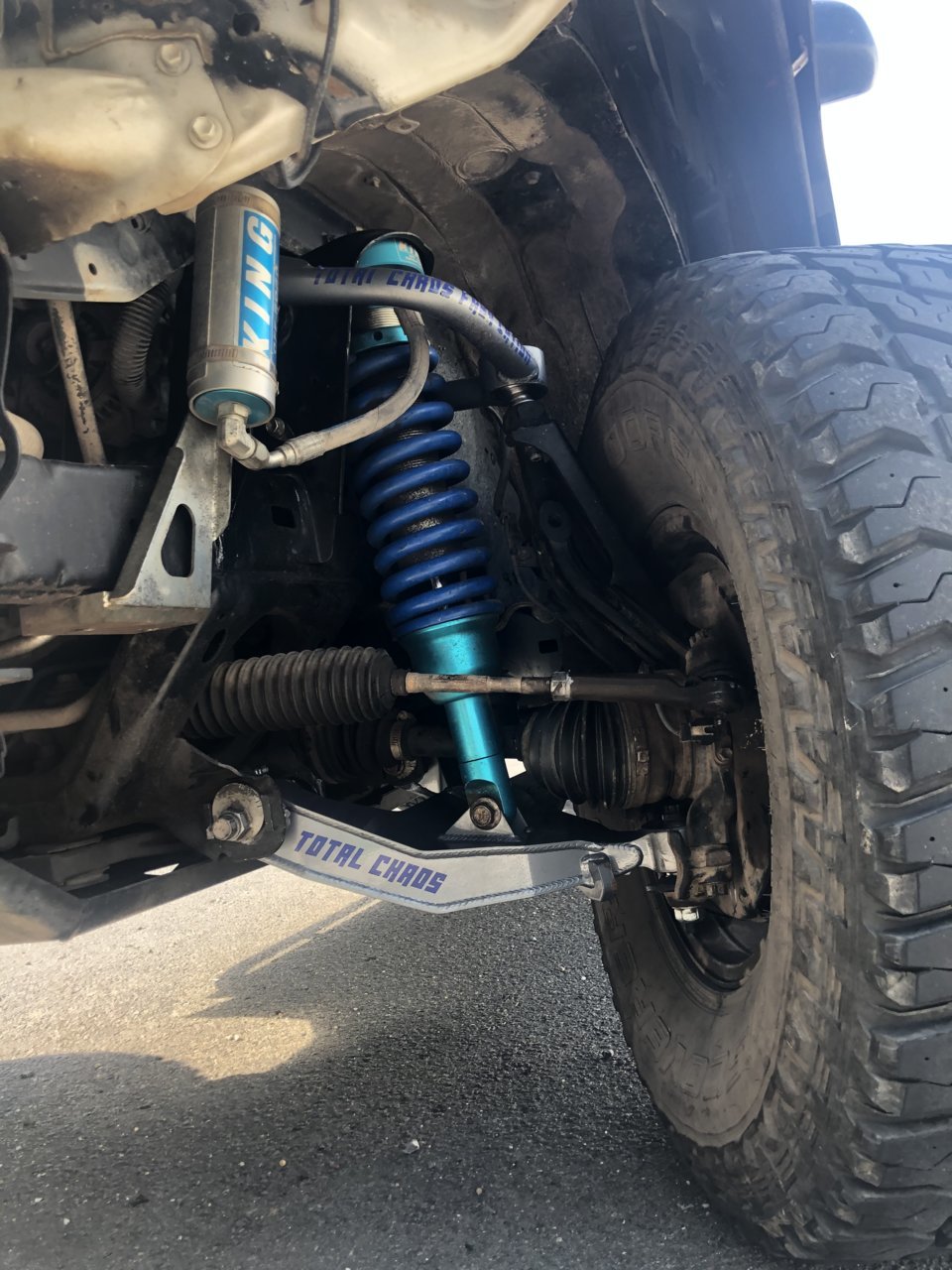

    780A4072-CFF5-4891-BC1E-F4B82B776327.jpg Finally after a few weeks to get everything together it is finally on. Even though it was a pain in the ass as we ran into issues it was worth it.

    What issues did you have?

    Had issues bolting in the ball joint bolts to the spindle and we couldn’t get one of the cam bolts through the driver side.

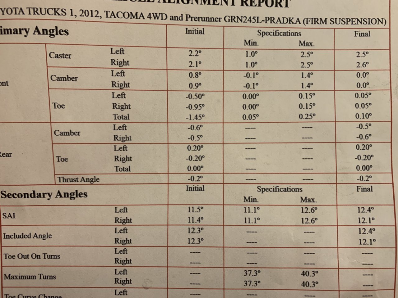

    28F3D092-6B2D-4FC4-A721-6915FEFA11CF.jpg Here is the truck after alignment. Not bad

    After getting the truck aligned I started hearing a popping noise at full lock. Last night I decided to make sure the cam bolts were torque to spec. Turns out they were not, today as I drove the truck I did not hear the popping. Hopefully I resolved the problem, I just wanted to throw it out there for anyone having issues.

    Always torque, test drive and torque again. You won't hear any more pops now.
