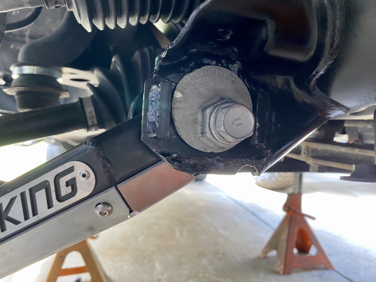

    Dirt kings installed, CMC done, Total Chaos Cam tab Gussets welded in, and 285-70-17's put on.

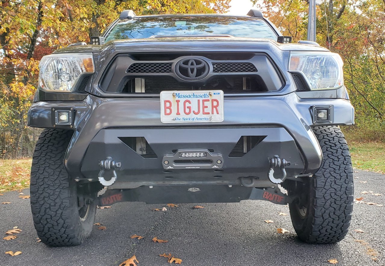

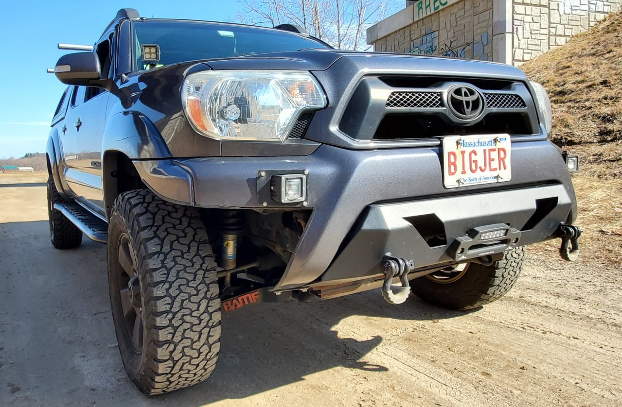

  5. Jul 17, 2020 at 5:48 PM
    #885
    crashngiggles
    crashngiggles Tacomaworld's Resident Psych Dr.
    May 17, 2015
    #155446
    7,497
    Jared
    Wilbraham, Massachusetts
    2013 MGM TRD 4x4 DCLB Trail Limo
    Yup....custom trimmed with a sos streamline bumper. I wanted to move the fogs up higher like a 3rd gen so I needed to customize my front end and fabricate new fogs and brackets.20200308_202359.jpg 20191026_152827.jpg

  7. Jul 19, 2020 at 10:26 AM

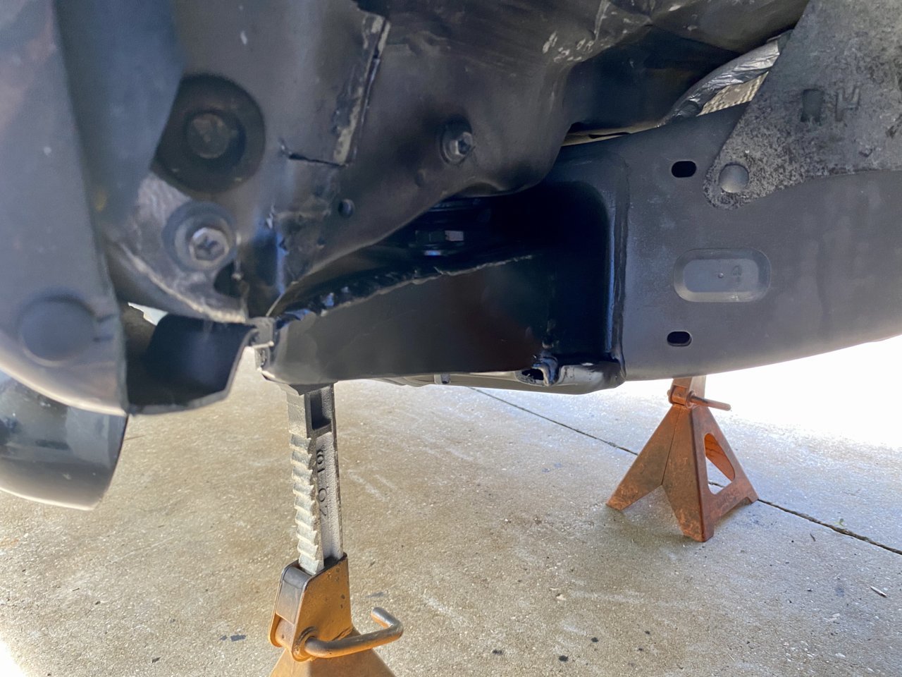

  17. Jul 25, 2020 at 10:11 AM
    #897
    T@com@Steve
    T@com@Steve Well-Known Member
    Apr 14, 2015
    #153198
    1,259
    Steve
    Sarasota, Florida
    15 4x4 DCLB
    Patched headliner, loud rack, too much shit in the bed
    Woo Hoo! Got new gussets and a chop! 45CD9789-331A-454C-B58B-B7C84966D1EE.jpg 544ABAE2-9BCB-4C44-BA88-72678C6598BB.jpg
