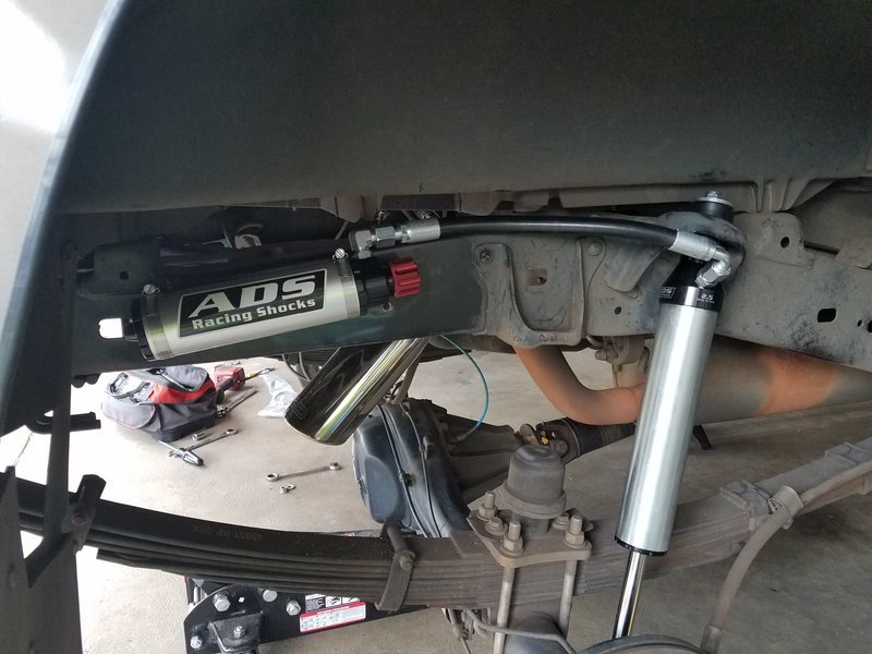

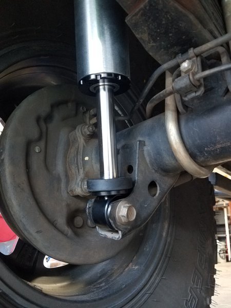

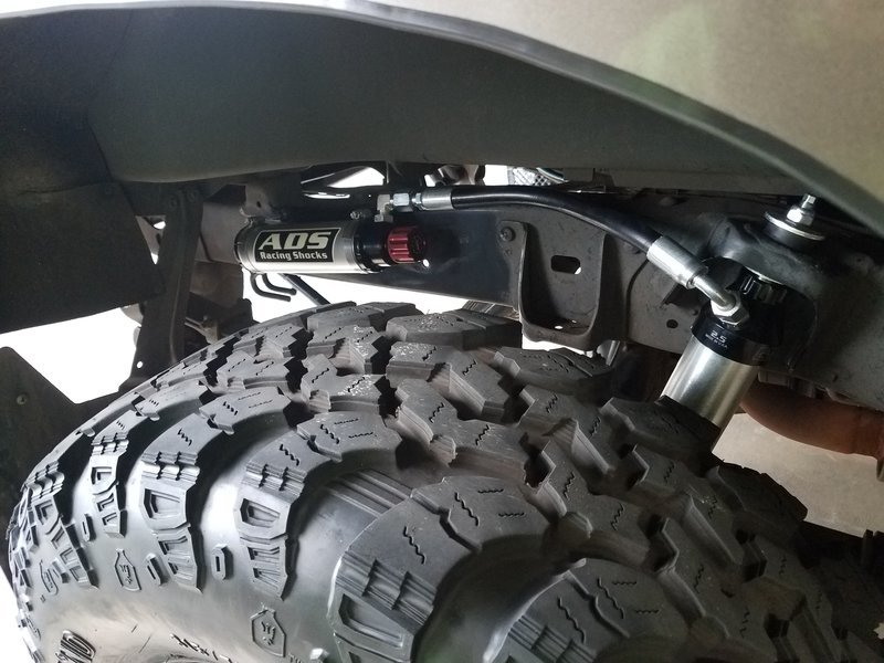

    The install went good. After installing I realized that the beefy 2.5 shock body would probably contact the axle mount when fully compressed. I think this would happen with any brand 2.5" shock you cram into the stock location. Here's some pics of the clearanced lower mount and the finished product:
    Before
    After
  7. Jun 4, 2017 at 9:29 AM

    Looks great! Thanks for sharing. My install is thisn upcoming Saturday, can't wait!

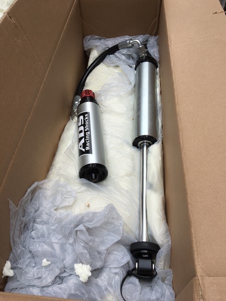

    For your rear 2.5 shocks, remember to check clearance between the shock body and the lower shock mount on the axle. You probably will have to grind the mount some so it doesn't contact your shock body when compressed.

    I saw your post and probably never would have thought to check. I will certainly check and make the proper adjustments now, thanks.

    Yeah, it can easily be overlooked because the shock is not compressed when installing.

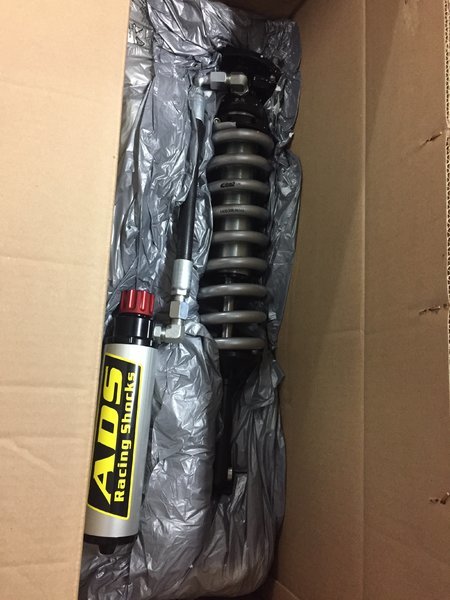

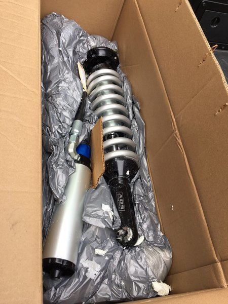

    Picked up mine today, hope to install this weekend.

    Ok having an issue with mounting the reservoir on the fronts. They will not fit into the brackets. The line is at the top and looks like it should be at the bottom. Anyone have this issue? I just called ADS and sent pics but no word back yet. Looking at Deeezy his is at the bottom.

    Maybe the sticker is on wrong? The hose is very thick and doesn't bend easily. I had to muscle mine into place.
    I would wait for ADS to get back to you.

    The only way I see it will work is crack the fitting and rotate 180 deg. The fitting needs to be at the bottom. I would think if I crack the fitting it will dump the gas.
    Same issue on both sides.
