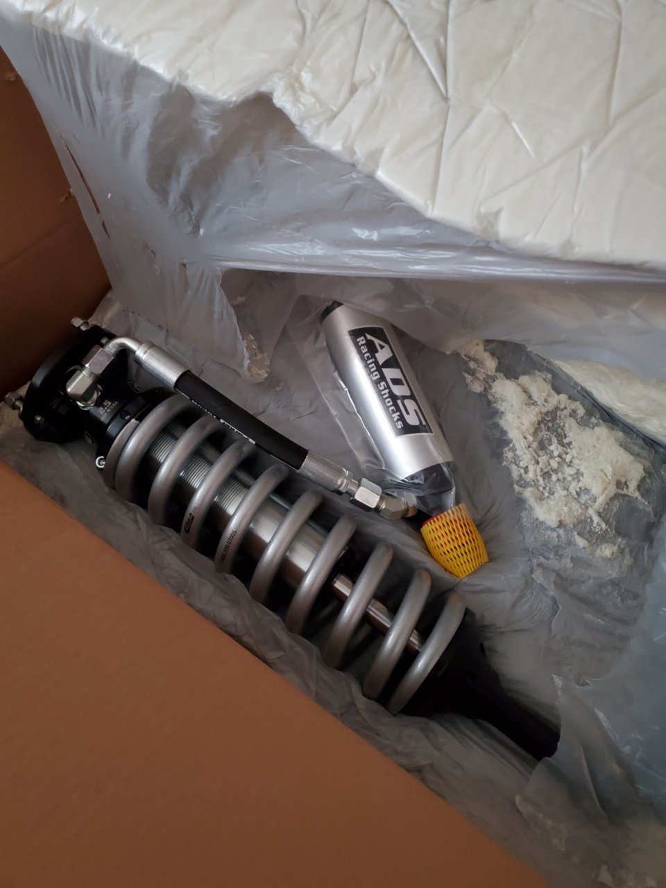

    HappyGilmore and ChadsPride like this.

    Hey @tacochep, looks like you got the same fronts as me maybe even the rears, did they come with resi mounts? looking online, the kings seem to come with one just trying to make sure i have everything sourced for install and no missing pieces.
    They look sick and congrats on getting everything in, I got shipping as well and look to be here Wednesday so i'm trying to make sure I can install this weekend :woot:

    Fronts and rears should come with resi mounts.

    Cool Deal, Yeah the rears did but it looks like it came with self tapping Screws? I figured we should be able to use existing bolts somewhere but as i have not started install i didnt know. Anyone who got the ADS 2.5 rears with resi's have a pic of completed install?

    Yeah it's a drill into the frame procedure. I highly recommend pre-drilling for those screws because they like to break their heads off. Ask me how I know. Also take care when drilling through the frame on the drive side. Lots of scary stuff behind the frame rail.
