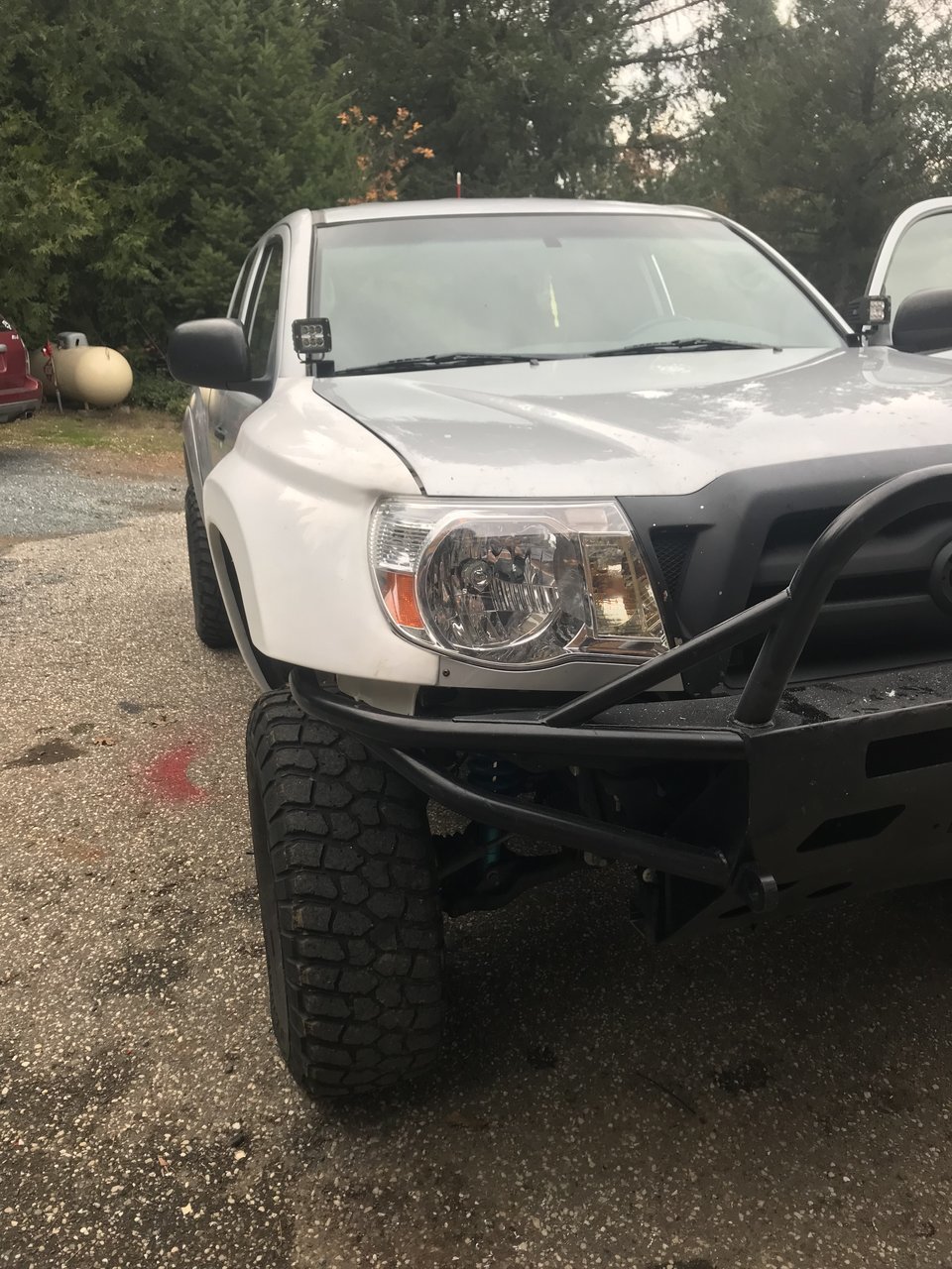

    0F4D8EBC-DF1D-4F6F-9D33-F57E0AEAC8ED.jpg Put in the little things below headlights. They look decent now. Can’t get those damn bolts on right below the headlight to the left..

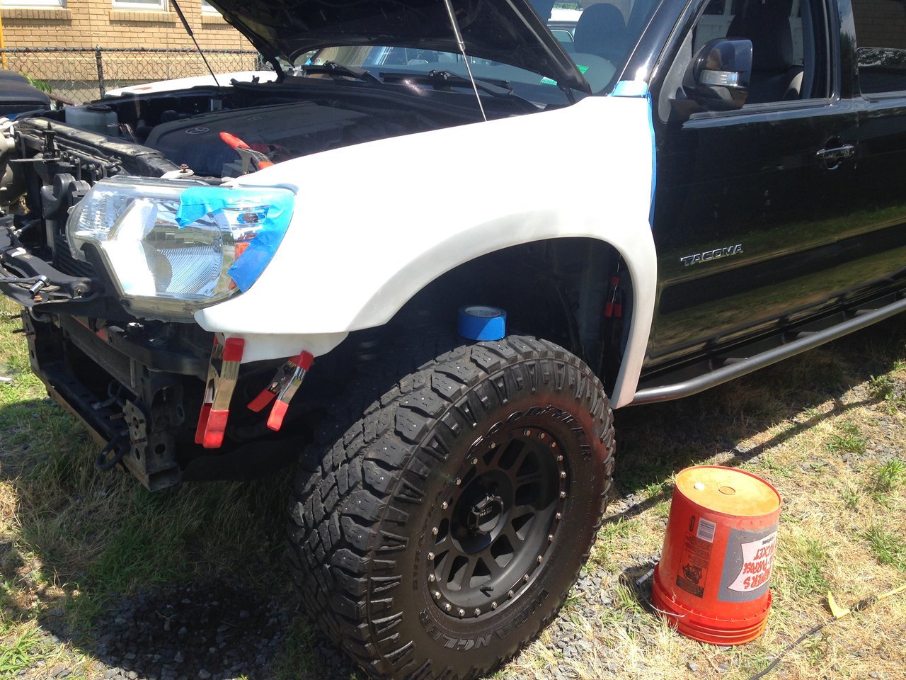

    Using these little spring clamps help me out a lot. After everything was fitting nice I took one off at a time, drilled and bolted. A heat gun will make the resin much softer and not crack when tightening along the top edge. The cold will make it more difficult to work with.IMG_2613.jpg

    I also took that small formed piece of sheet metal off with the fixed screws below the head light and drilled those holes last.

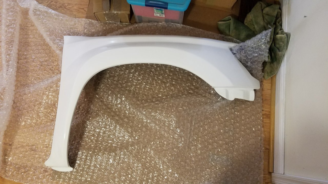

    A few quick question for all of you that lined the inside of your fenders.
    1) What did you use? I'm looking around and there are a lot of options for paint/roll on bedliner; I'm just curious what others have used.
    2) Do you line the entire thing or do you leave the edges that bolt down clean?
    3) Do you fit first or line first?
    Thanks

    Fit first so you can sand and in the event you have to add some glass for fitment it's a clean surface. They'll also be lighter to work with.

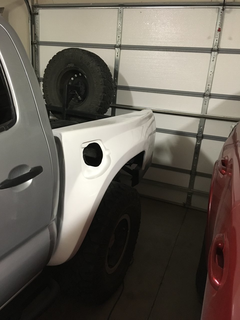

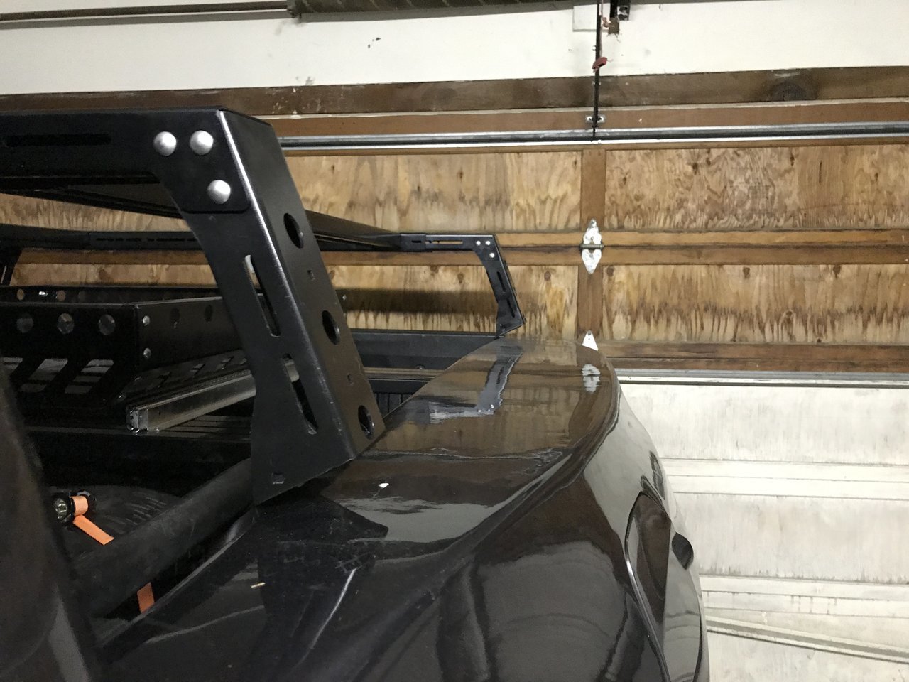

    So I'm finally getting around to installing these this weekend. For those that did bedsides, what if you do to your filler neck to get it to reach out all the way? Mine isn't even close to sticking out enough to fit into the door? Also looks like I'm gonna have to do some work on modifying the bumper so things line up. IMG_1879.jpgIMG_1883.jpg

    I have a set of these at ADV I need to go pick up next week... I would do an extension. Take the filler tube off a cut it in half. Then go to the parts store and get some rubber house and clamps that fit it. Pretty common for the old school body lifts of yester year, still required for some glass. And ya get that bumper “adjusted” to line up, you will appreciate the finished product.
