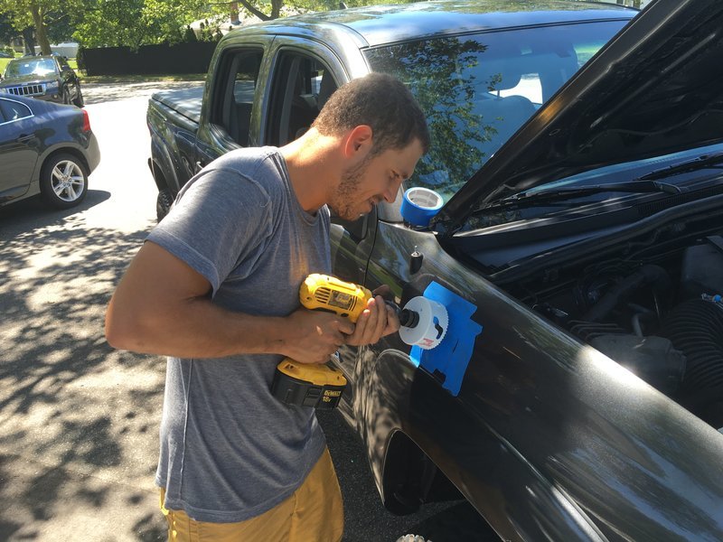

    Here's a tip for you guys that I was going to share with @uurx .. when you put your template on it's just a guide so screw in the threaded screws to the snorkel and mark the ends with black pen then press it against the template as to where you want to place it. It will help you get your snorkel as snug to the Truck as possible allowing you to use the velcro method if you choose

    Lol! I'm just saying that there is room for error for those of us that perhaps are not the perfectionist type

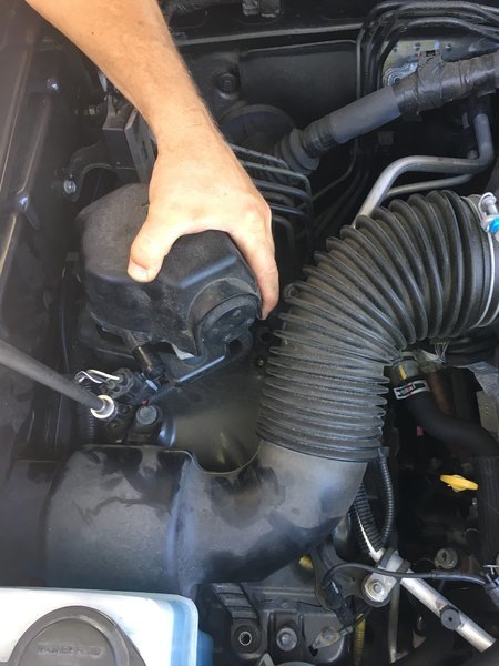

    Oh yea and guys that ar 2012 + you're going to need to remove the windshield washer fluid and emissions sensor? See pic IMG_1063.jpg
