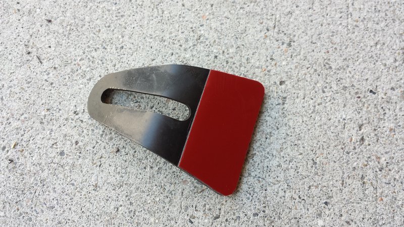

    more specific you are talking about the 5 screws that go from fender into the snorkel body and the two holes from the snorkel body that meet the clamp on the pillar correct??

    Just the five that go into the body. I suggest fabbing up something new for the pillar or using the tape method others have. The pillar shit they provide is lacking IMO so I have a different, heavy duty bracket sitting, waiting to go on for like three years :anonymous:

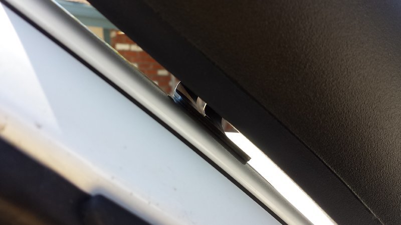

    I took a hammer to the pillar mount bracket to straighten it out a little and used 3M double sided tape to the pillar. Been holding up just fine, in crosswinds, dust, rain and all.:anonymous:
