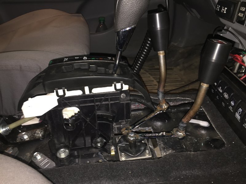

    Did you use an open ratcheting wrench?

    @HolyHandGrenade is well known for using wrenches to suit any purpose:

    Found the pic of @HolyHandGrenade 's wrench twin stick levers.

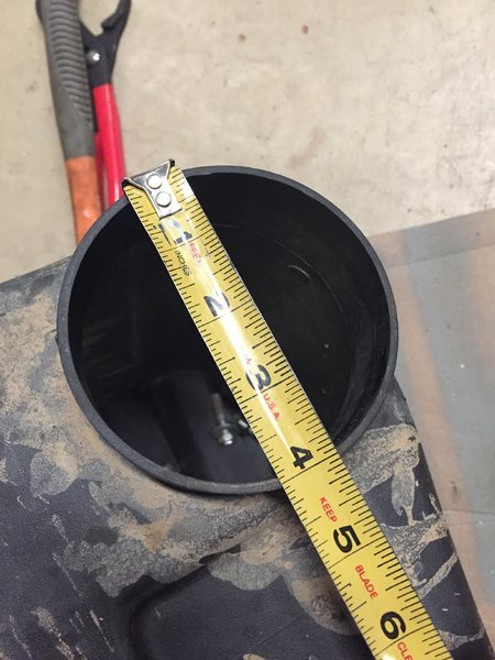

    You have to have something coming off the filter housing and going into the fender. I can see it on mine when looking down at it between the housing and the inner fender. What diameter is it?

    Ill get you an exact measurement in a while. But its about a 4" OD. There is a rubber "velocity stack" that goes above the fender liner, and thats it.
    I have all of that out, so i can take better pictures for you.

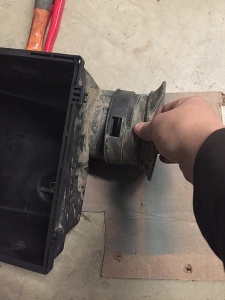

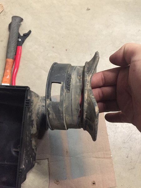

    @stairgod this is what's on the intake box
    I cut the lip off, trying to use that rubber piece as a coupler, but didnt work.
    And the 4" fernco was too big. The 3" fernco fit inside, but didn't fit the elbow of the snorkel part. I have something else that I hope fits..
