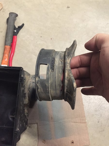

    the guy said that piece fits his TRD CAI. Just don't use that elephant pecker piece that the TRD kit came with.

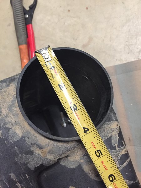

    What is the Dia of that flexible tube? HPS also offer's aluminum tube by the foot. Might be able to get the same tube from from an exhaust shop, and HPS also has elbows
    The TRD outlet is a different size from what I understand. That's why I bought this silicone piece.

    HPS 4" 6061 Straight Aluminum Pipe Tubing 16 Gauge - sold per foot $34.99
    OD: 4" (102mm). Wall Thickness: 16 gauge. HPS 6061 Aluminum Straight Tubing is commonly used in industrial, automotive, marine and aerospace industry;
    Great for custom fabrication project such as DIY air intake, cooling systems, turbo intercooler piping setup. Learn More

    The piece I got is the same size both ends, so time will tell. The TRD kit comes with a flared end sleeve. Just use the silicone sleeve instead of that flared end piece

    The flare is removable. I thought I could use that, and took it off and cut it. Didnt work.

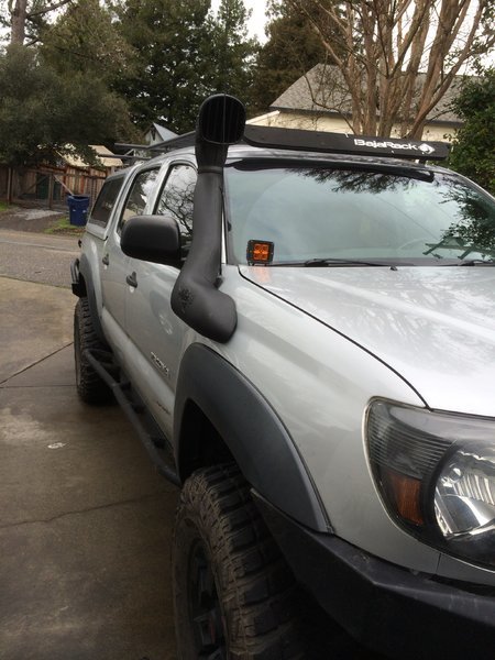

    Dad, why are you drilling a giant hole in the side of Trucky?
    Because SNORKEL!!
    It was a pain. Do yourself a favor and pull the fender from the get-go.

    Did my install today and used a hole saw with no problems. I put primer on the ends of the studs to mark the taped fender instead of using the Airflow template. Some of the studs matched the template dimensions and some were out as much as 3/8". I cut out the inner fender brace with a dremel and tin snips. Used the snips to also make a cut in the stock inner fender hole for the intake and then took some pliers to bend the sheet metal out to widen the hole. That was a necessary step after a bit of cursing trying to fit the elbow on the stock intake tube. Of course that pain in the ass top rear stud is a pain in the ass no matter what. I didn't remove the fender or even loosen any of the fender bolts, but I did tape a long 3/8 extension to an open ended 10mm wrench so I could crank down on it easier.
    RIP to the A-pillar bracket bolt that I dropped and slid down my A-piller then into the void between the inner fender and windshield cowl (I have CBI ditch light brackets so the cowl is cut there). I poked around in there with a magnet but I'm afraid it's not gonna come back across enemy lines. Luckily I had another bolt damn near identical to the one included in the kit.
    I need some fender flare clips and then this sumbitch can get put back together. In case anyone is still looking for black hose clamps for their pre-cleaners I got mine here:
