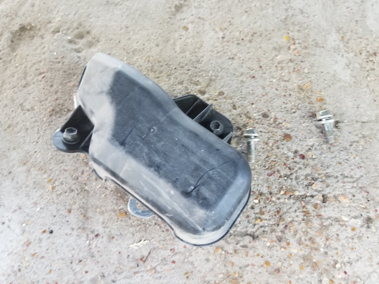

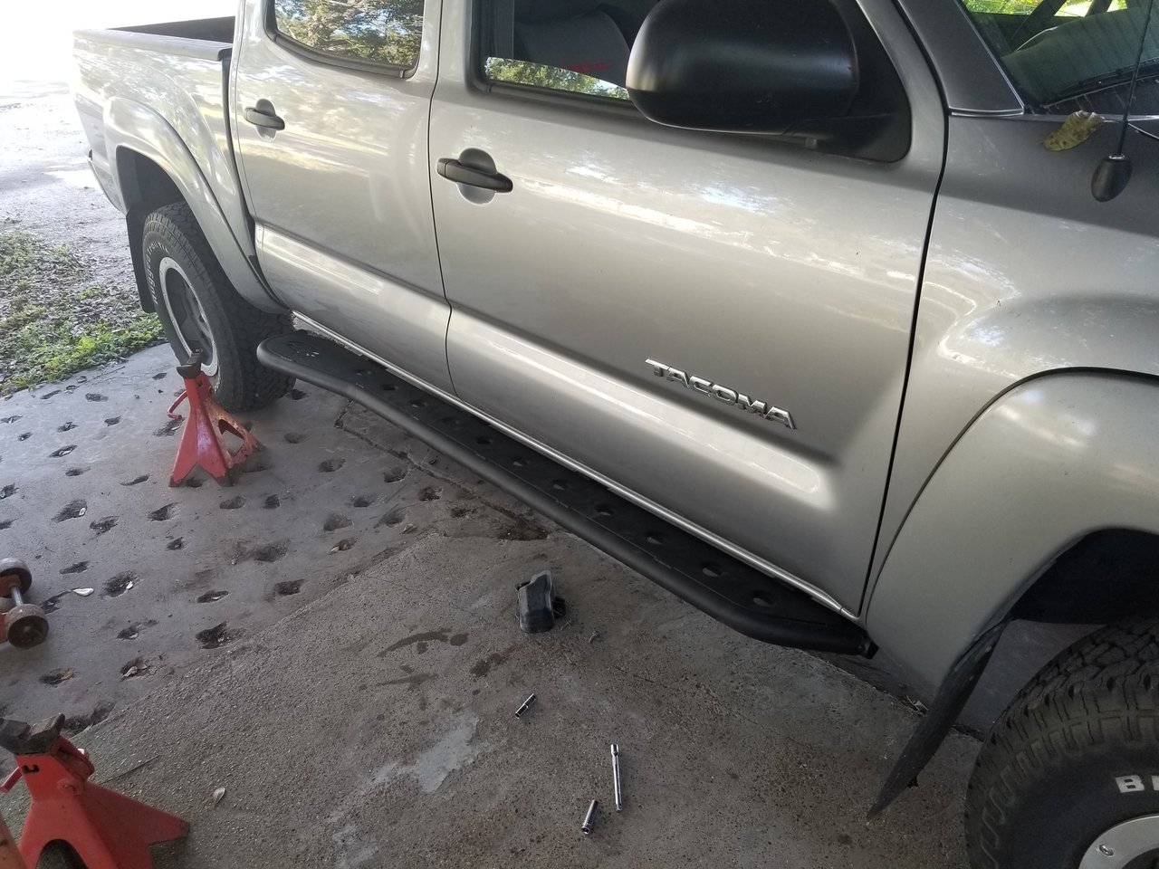

    i managed to trim a corner of the box so it can fit around the leg of the slider.
    scooted it over and bingo

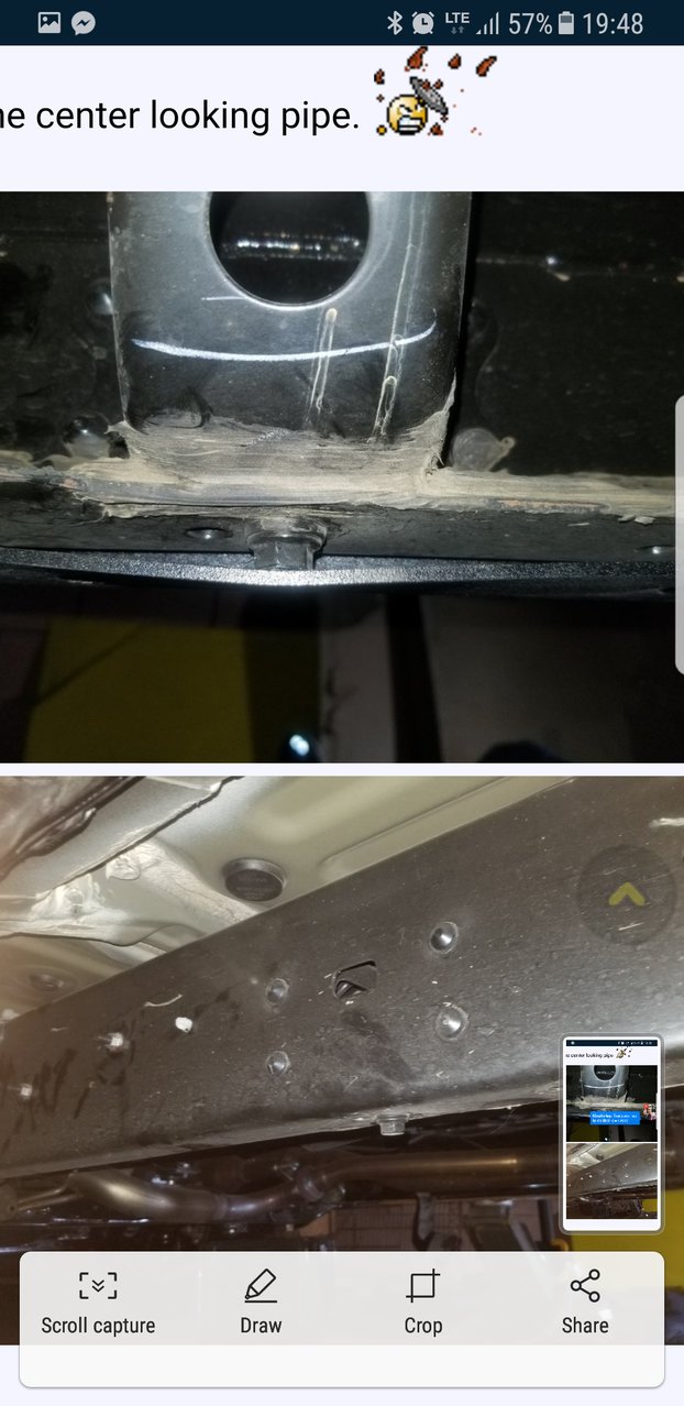

    This will probably be a double post. But looking to see if anyone else ran into this problem Where there isn't a cut out for a bolt that is on the underside of the frame. The bolt appears to be holding a brace for the drive shaft.

    Negative.

    I just drilled a hole for it even though All Pro should've done it from the beginning.... :rolleyes:

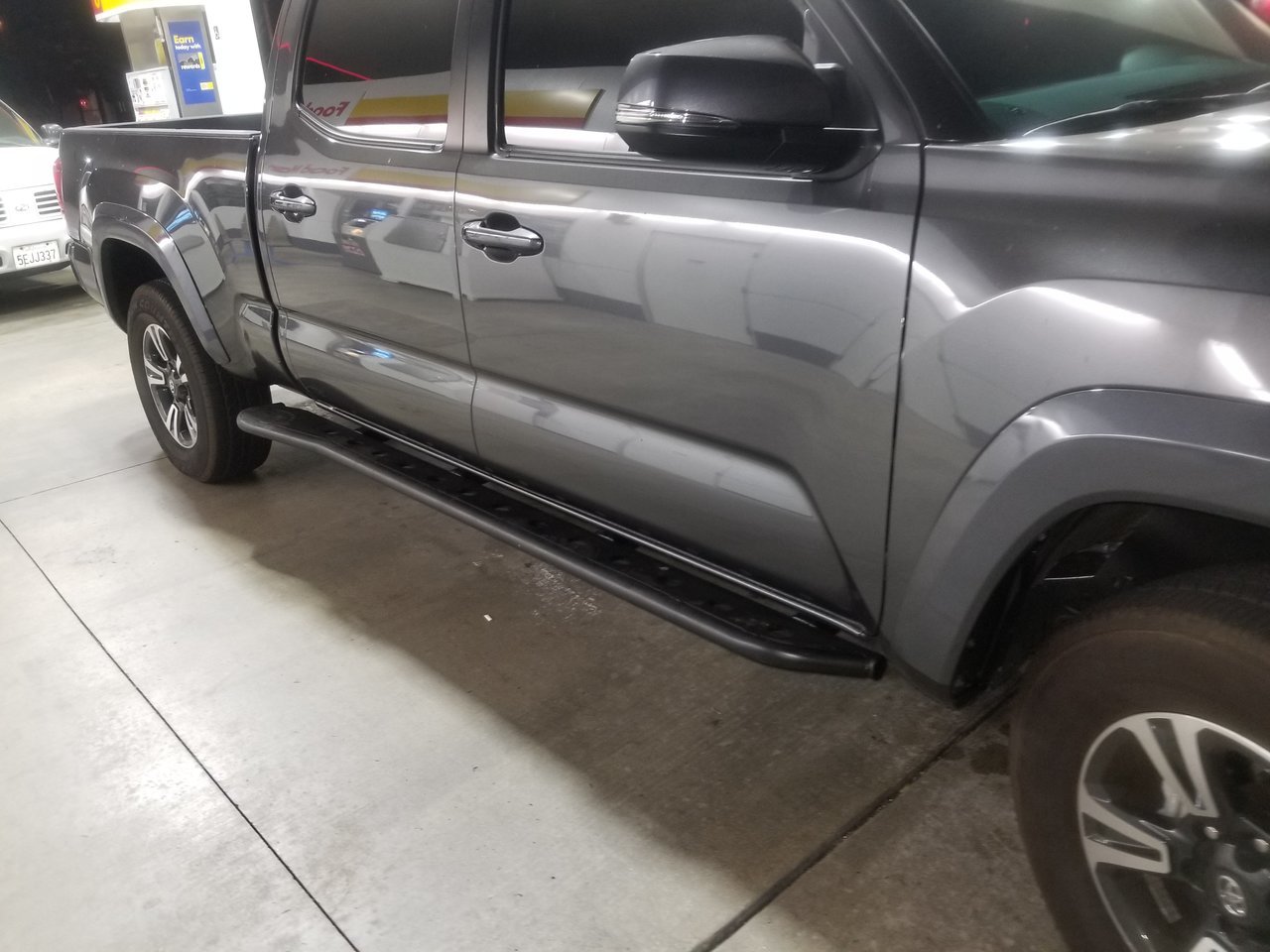

    Yeah I ended having to do the same. Overall i'm happy with them. The driver side wasn't as difficult as I thought it would be. I was still able to use 2 of the 4 retainer clips to secure the brake lines. And as for the nut plate that went into the cut out. I used a telescoping magnet to hold it into place.

    Looks great :thumbsup:
