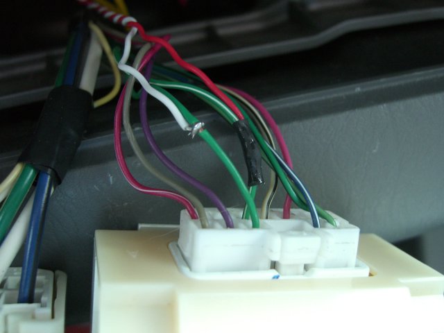

    Just swapped out the Caliraised switch with a CH4X4 switch. Much better and looks OEM. Got the idea from maxtherat. I followed the same wiring setup that TexasGunGuy88 did but I didnt tap into the fuse panel for the switch backlight. For my 2010, I tapped into the AC Heater lighting circuit. If you have a 05-15 you can search for rcbs204 thread (https://www.tacomaworld.com/threads/rcbs204-4x4-illuminated-switch.68173/) on his illuminated 4X4 switch. If you read his install instructions he taps his illuminated switch wiring into the AC Heater control panel backlight wiring. I did find out the difference between the two lighting wires that you can tap into. If you tap into the solid green wire your led bar switch will NOT dim when you adjust the dimmer for the rest of your instrument backlighting. But if you tap into the green/white wire, the switch will dim with the rest of you instrument backlighting when you adjust the dimmer. What I did notice if you turn the brightness all the way up the switch backlight will go off. Im not sure why it does this. It might only do this on my truck because I have already tapped into the AC Heater panel for my lighted 4X4 switch panel. Have any questions about this, PM me.
    This is a picture from rcbs204 thread on his 4X4 lighted switch install. You can see the solid green or green/white wire that you can tap the LED Bar switch into so that it will light up with the rest of the instrument lights.
