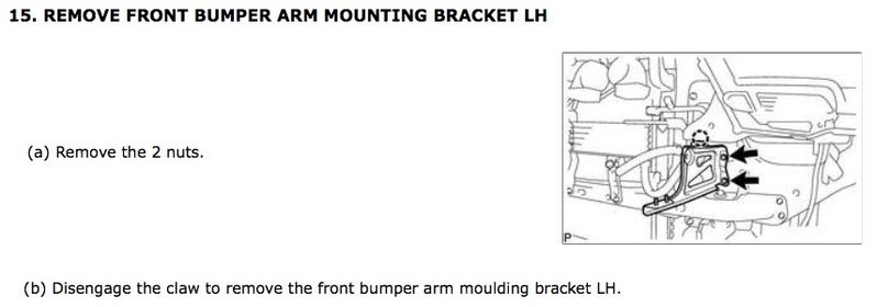

    Must be missing something... is this correct, 43 ft/lbs, for the crash bar bolts? I have been searching everywhere and can't find anything.

    Is it the second and third line item here?

    Hmm... I don't think this is it... here's a picture of the "bumper extension LH"
    All I need to know is what the damn part is actually called!
