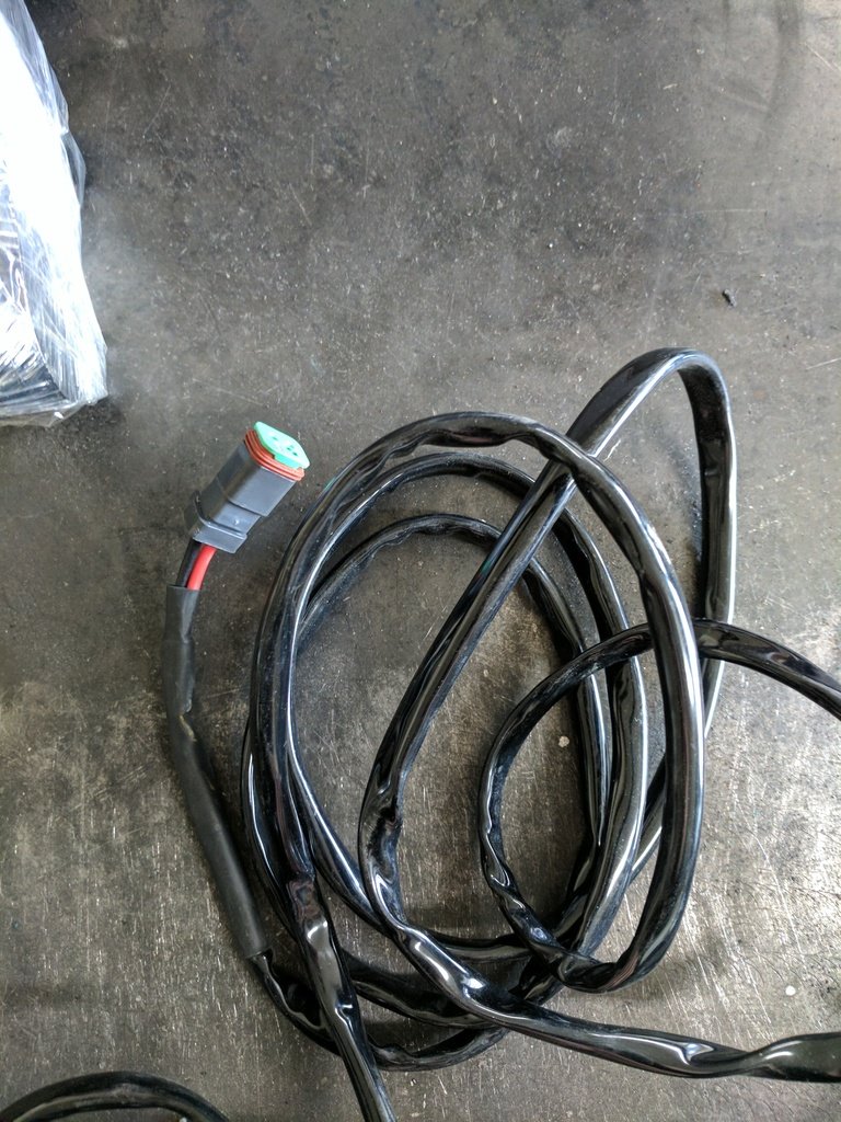

    Do you know if the premium harness is compatible with other light bars? Is that connector a common one among other brands? I wish CaliRaised LED would make a 50" curved bar and I wouldn't be asking this question

    They make a 52" curved... If the other brand uses a DT connector then yes.

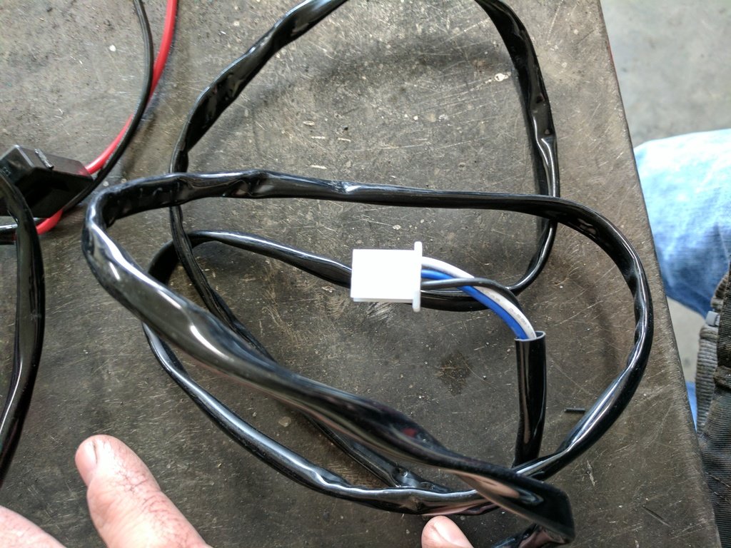

    When wiring the LED bar I found getting the three wires through the nipple on the drivers side a serious PITA. When I wired the tailgate lock I used the passenger side nipple and it seemed much easier to wire. In any case, I made it work by taking the three wires out of the white plastic jobbie and then stripping back the black plastic outer layer about 18 inches. I was able to fish one wire through after about 10 minutes of trial. I then tightly taped the second wire to the first and from inside the cab pulled the second wire through. I then taped the third wire to one of the other wires already through and pulled it through. This was by far the most tedious part of setting of this light bar.

    I agree, I had the same problem with fishing the wires through the firewall. If Ohiotaco68 didn't tell me about the little nipple I think I would still be working at it. He was a life saver for me. Good forum partner.

    The nipple on the driver's side is small. I have run 3 small gauge wires through it. Don't think I could get anymore through. The number of wires would depend on the gauge of the wire. I used a coat hanger to get the wires through and it was all by feel. Never did see the nipple onLY pictures of it on this forum. HA! HA! HA!

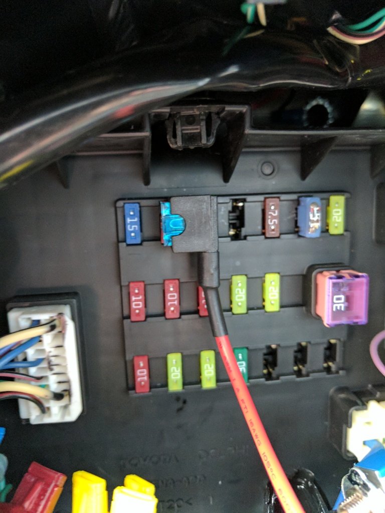

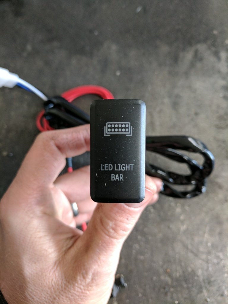

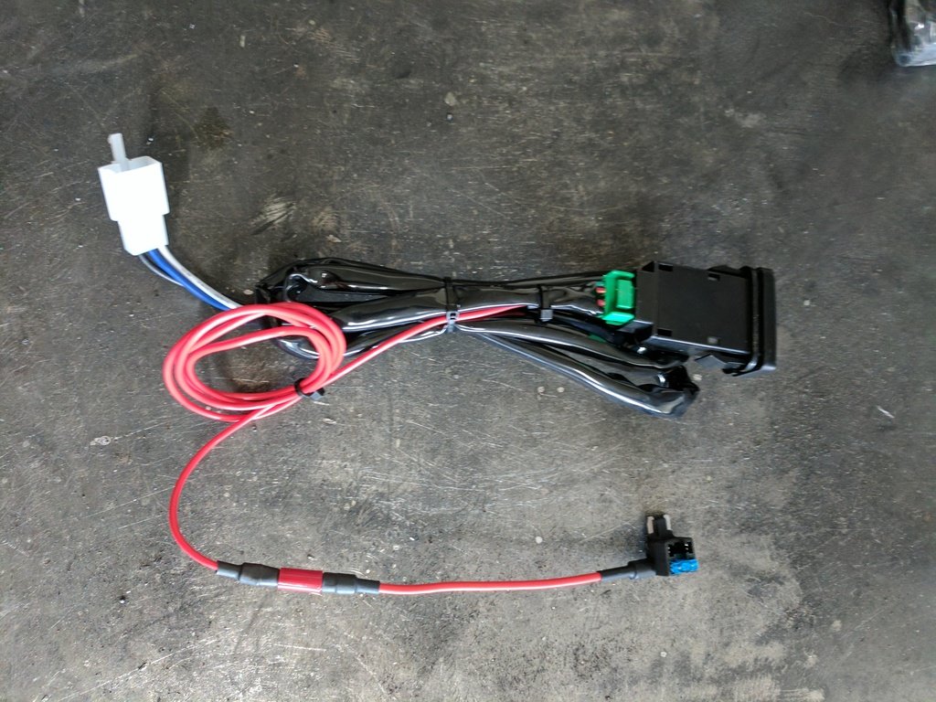

    Finally got around to installing my light bar with this harness. Super easy. Took about an hour in total. One question. What fuse are you taping? My fuse box looks nothing like that? I thought the switch was supposed to light up when the dash lights and headlights are on but mine only lights up when the light bar is on

    You can slide the wires through by pushing the entire grommet to the side. I couldn't get it through the nippple but got it through the side and then just pushed the side back over the wires, haven't noticed any side effects from doing this.

    Oh, and I meant to post my question here but accidently did to another thread. My question is what is the necessity of doing the add a fuse to the mic tuning switch that was done earlier in the thread? My buddy and I did not..

    Find the brake light fuse on the diagram. Use that one. No matter what year or model they all have this one somewhere on the fuse block
