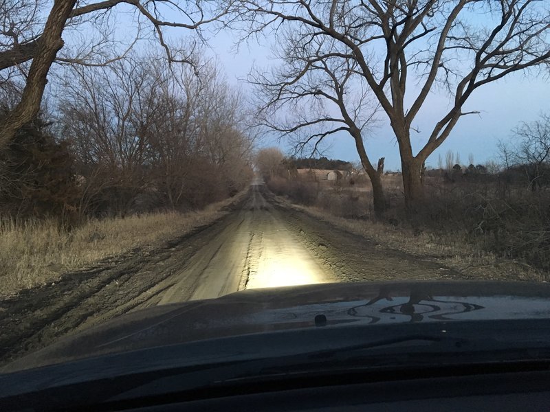

    Here she be installed.. great product!
    And I took this simply to show my current spread, this is NOT representative of the actual brightness (it's about 10 minutes after sunset here and still light out). I have a hunch that it might be aimed a little low? It seems that the bulk of the light is centered pretty close to the truck.

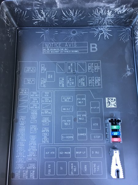

    I don't have anything that is obviously a brake light fuse. Here is what I have. I am currently tapped in but the switch doesn't illuminate unless the light bar is on. Which would should I use to make the switch work as intended?

    Looks like your bar needs adjusted up a bit .. or is it just me

    You should inside the cab in that small fuse box

    Yessir. That worked! Thanks
    Next Question...I ordered another premium harness and will be adding a bumper light bar. What fuse should I tap for a second light bar to retain the same kind of function as the first?

    A second... I am not sure exactly. Simple way to fins out. Get a tester and see what fuses are off when the lights are off, then hot when the lights are on. Most fuses have the little spot on top for you to test without pulling so you could do this rather quickly!
