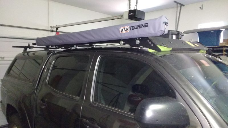

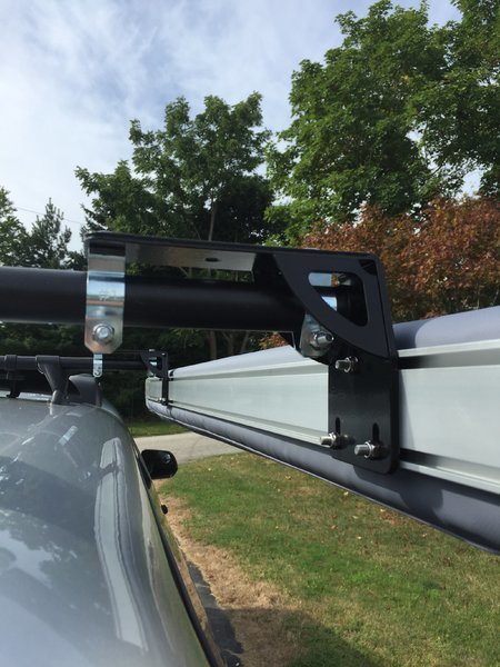

    Mounted to Yakima crossbars with 4 #1 conduit hangers and ARB brackets.image.jpg

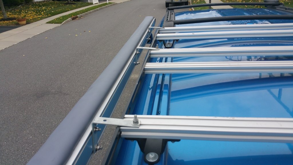

    Mounted picture

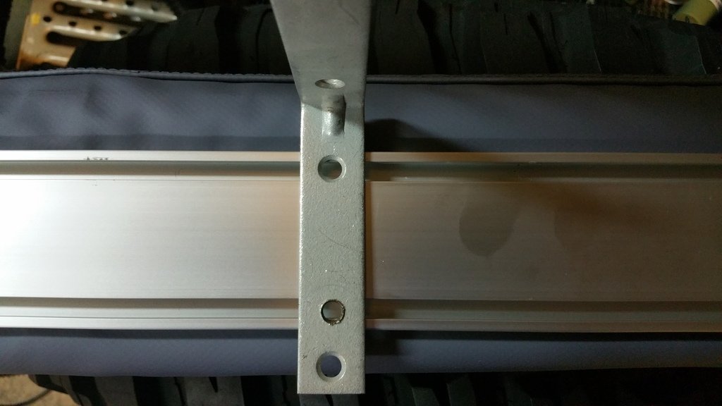

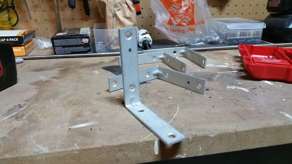

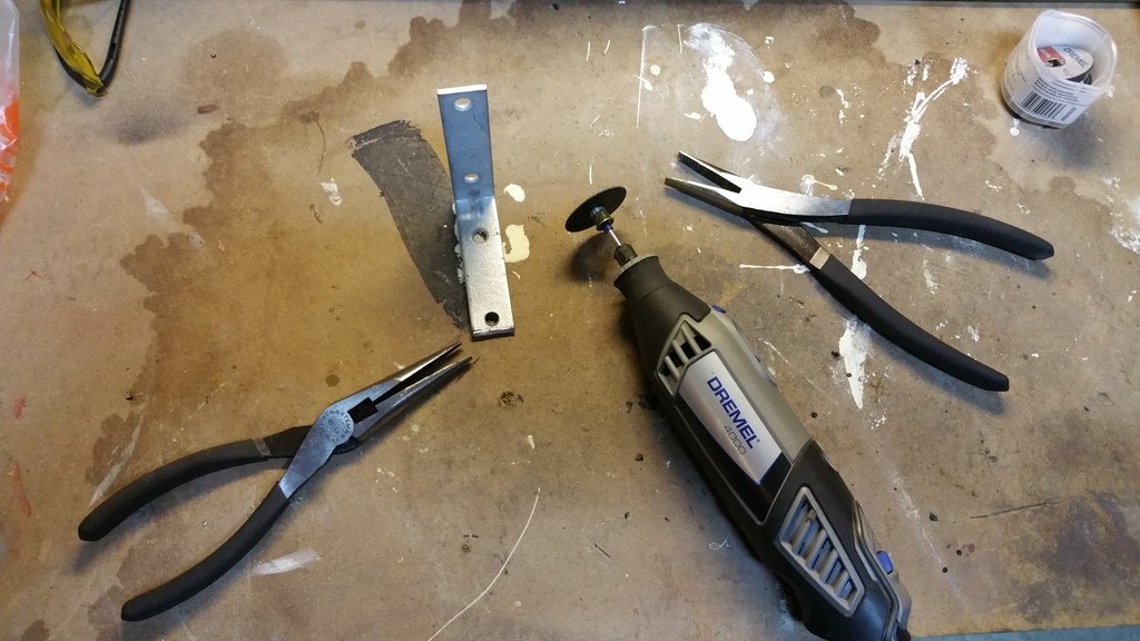

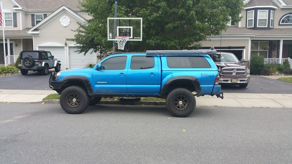

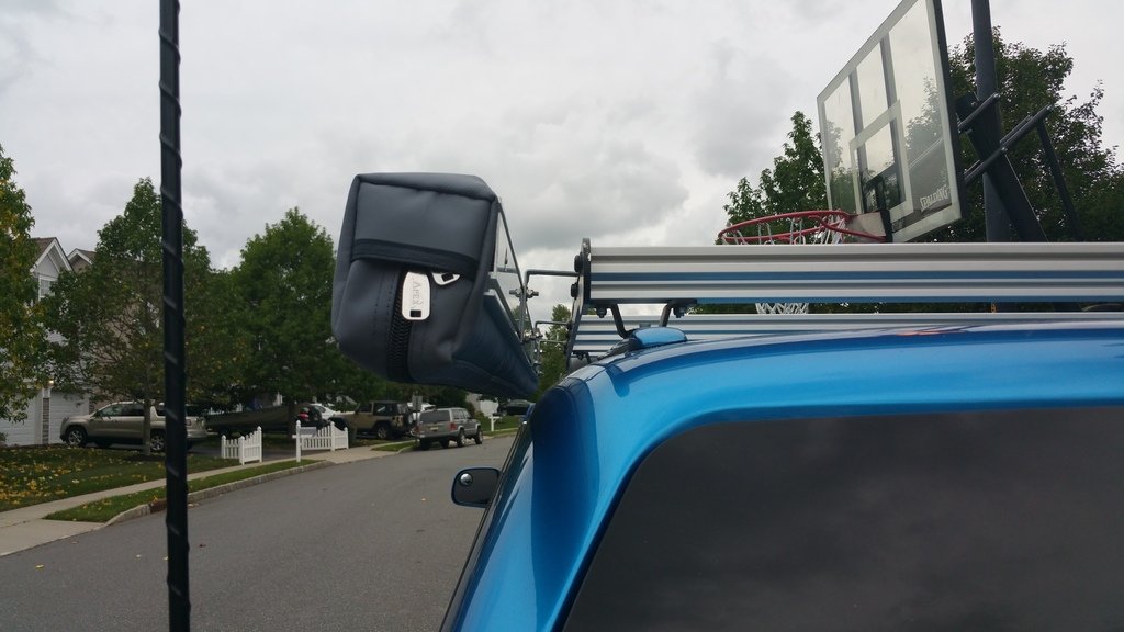

    Mounted up the awning with some brackets I made for about $7 at Home Depot.. I picked up a set of 4in galvanized steel L brackets that look like this:
    I had to mark and drill a new hole so they would line up with the Awning slots. After drilling it looked like this:
    I then cut the excess steel off with a Dremel and some pliers. I didn't have to do this but i figured why not:
    Finally I mounted it up to the truck and it looks great.. The mounts are super sturdy and I was able to utilize all 3 L brackets.
    I also clear my rear door by about a 1/4 inch

    Do you think your door would hit if your flexed out at all?

    No I don't think so.. Theres a pretty decent amount of room between the awning and my door but i'll keep that in mind the next time i take the truck out

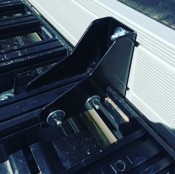

    If you have a Prinsu Rack things just got better. He just made bracket for awnings. I'll need to add it to my order now...LOL!
