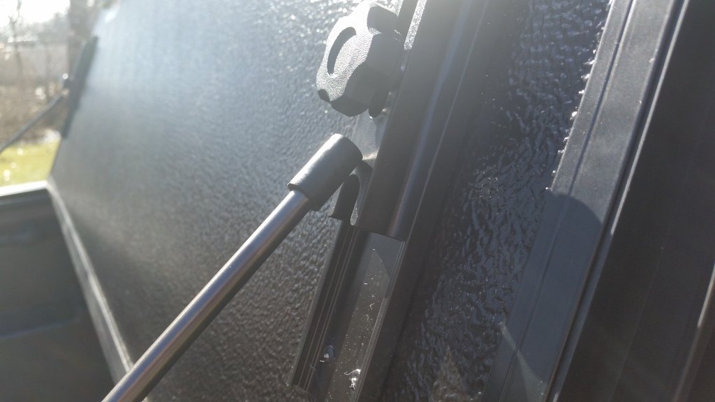

    I put some fender washers between the brackets and the truck bed to get mine to fit better.

    anyone else have this problem?

    Just loosen the knob and slid it up, then down to lock the bar in place.

    Which cover is this for?

    Bakfip VP. And i cant push the slider up and further any further without grinding it. The rivets are in the way...
