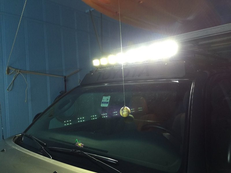

    I wired some lights today. Here's the roof lights. I have eight 18 watt pods. I had to take the picture at a sharp angle to keep the light from washing out the image.

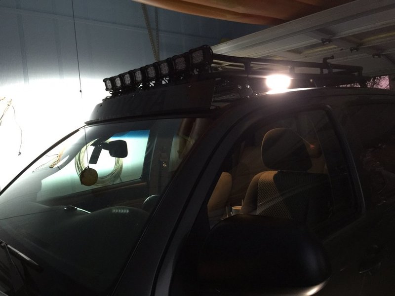

    Here's the alley lights. One 18 watt on each side. I used one of the non-relayed wires.

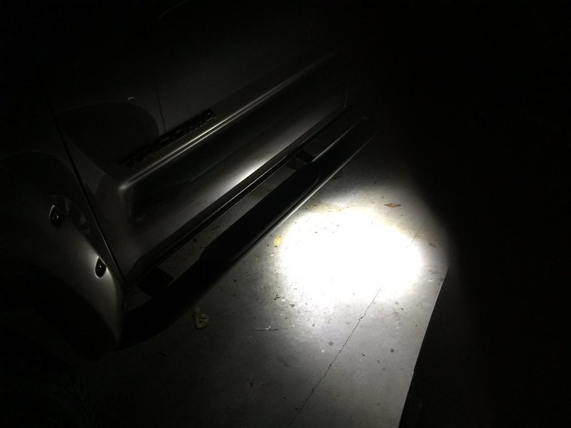

    Puddle lights. One 18 watt on each side mounted underneath near the frame. I used one of the non-relayed wires for power, and used the dome light ground so these lights would come on with the dome light.
    Puddle and alley lights on together.

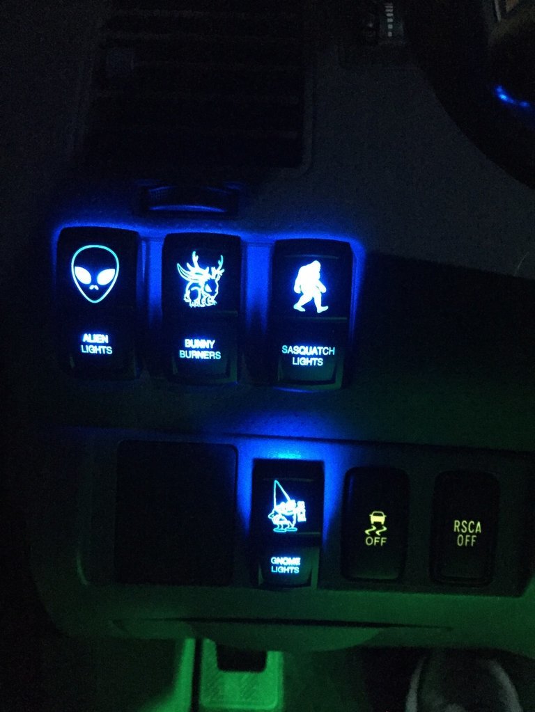

    Switches.

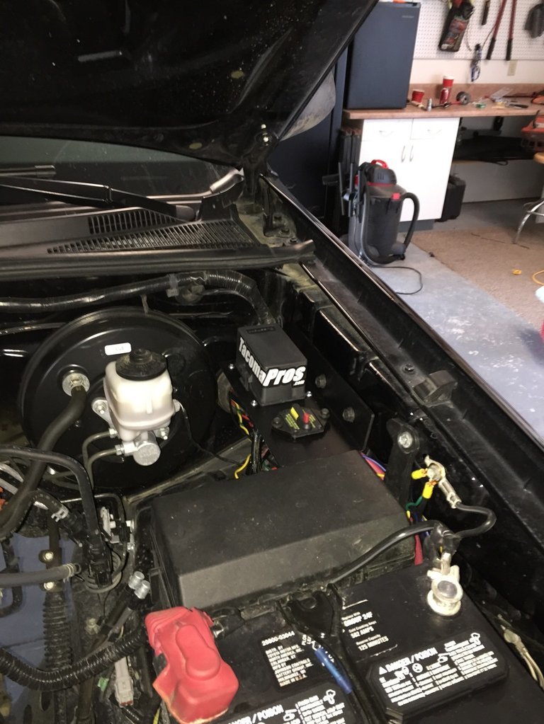

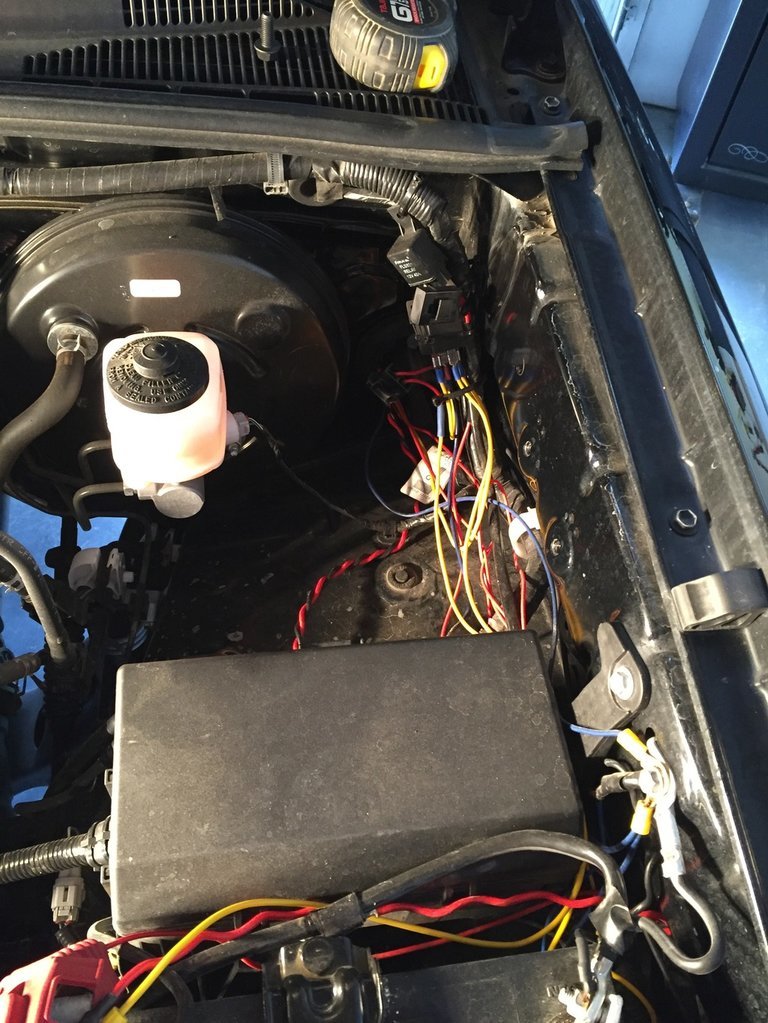

    I'll just leave these here!
    7311BEB2-5A41-4970-A4B1-216D6BEA65DB_zps_efb7292d9d7b678be930004dc6d442224ce53d54.jpg
    Before!
    59B8F546-66DB-4E18-ADDC-B886D0F8368C_zps_ef52f50ac1c4e845d577e4a7670b5c61a3e21beb.jpg
    TacomaPros
    0E658AC1-D533-4EED-BBEB-D229B2422CD8_zps_53069c27311dc2a68b38d7722efcad5c851e3c8f.jpg
    99554DE9-8963-4C97-B589-B12072FBEEF1_zps_4f963c7e5812d49f3e14ea15294b5b8845b65bcc.jpg
    50B288CE-5704-4519-B41A-29100BEAD1B3_zps_d07cf53f5b8cd813bdff70d05b207151e7bc7321.jpg
    Don't mind the dust light lower not on. I haven't energized that circuit yet.
    C1C799D5-D5D1-40C9-8069-1EF54593BAA2_zps_26cd8368b0654c6209d479b5b860be74e0356787.jpg
