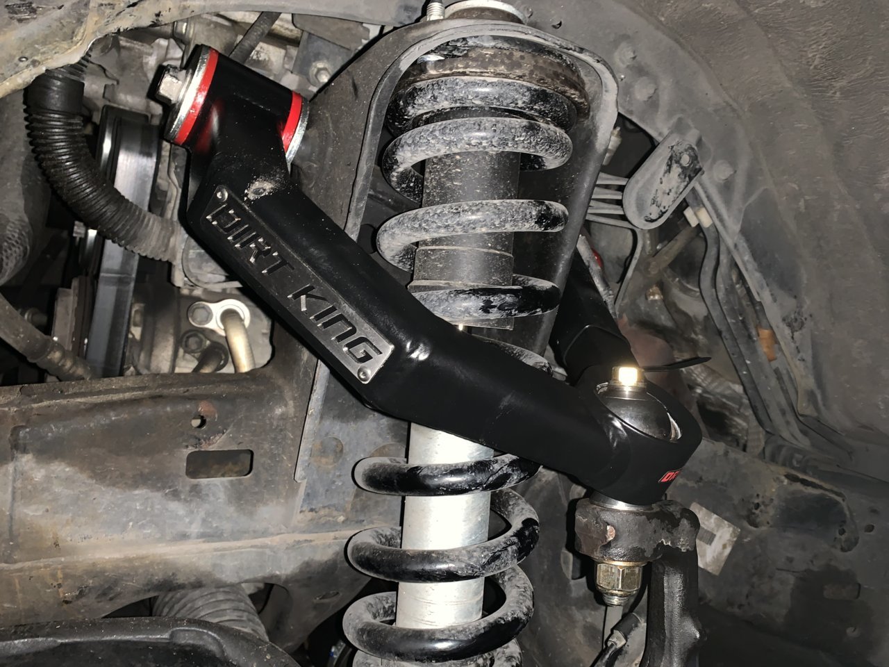

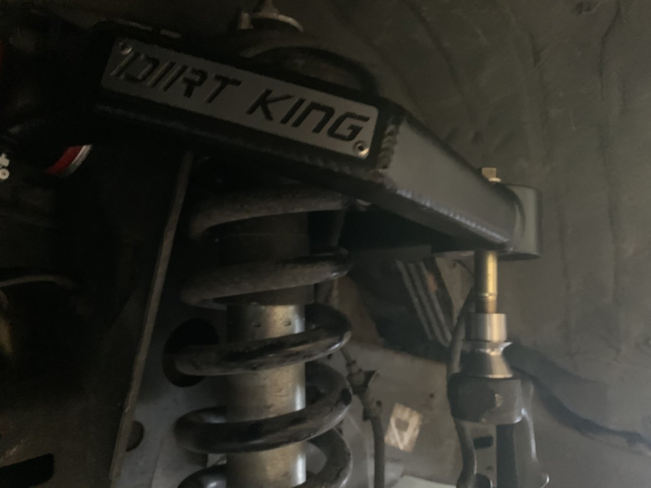

    Install question. trying to line the uniball up with the spindle without damaging the threads. I cannot move the ball to align it. I’ve tried various ways to shift the spindle but I really think I need to move the ball outward. Tips on next steps?
    another angle / variation with the misalignment in the spindle. Can I tap that thing down?

    I'm not spun up on uniball's but I don't see why it wouldn't move, maybe give it some gentle love with a rubber mallet or dead blow?

    Rubber mallet did the trick. One side in. Gonna torque it and get the wheel back on.

    Place a jack under the LCA and jack it up.

    Damn that looks so good already
