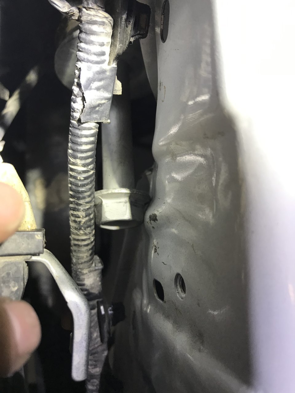

    Any anyone’s driver side hit the battery tray this much?!!
  10. Jul 18, 2020 at 6:14 PM
    #270
    Mully
    Mully Well-Known Member
    Feb 12, 2014
    #122907
    5,272
    CA
    12 DC 4x4 Lifted Sport
    Lifted, Kings, Locked, 295s and more.
    Yep, bend that shit out of the way, it will come out. You will be able to bend it back, thin sheet metal is all it is.
