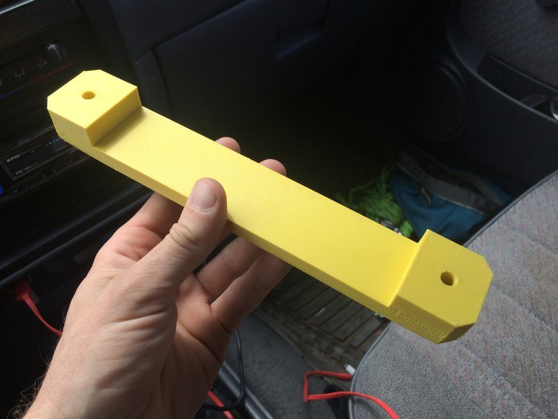

    For those that would like a different battery tie down option... Here it is! Introducing, version 1 of my new SLIMMER, NON-CONDUCTIVE, tiedown. They will eventually be made in black. This one will be going through strength testing and then it will be available as an option when purchasing a tray. I will also offer them individually to folks that have already purchased a tray.
    Blackouts, ebbs15, Chipskip and 4 others like this.

    #330
    RCRcer
    RCRcer Well-Known Member
    Jul 14, 2015
    #159476
    879
    2015 OR DC
    NICE! I'm in for a couple of those when they are complete. Don't get me wrong the original tiedown is awesome, works great and looks bad ass. Buuuut, I've already done a bit of spot welding on one of them LOL. No matter how aware and careful you are, adding more cables and rearranging lugs can be invigourating at times.
