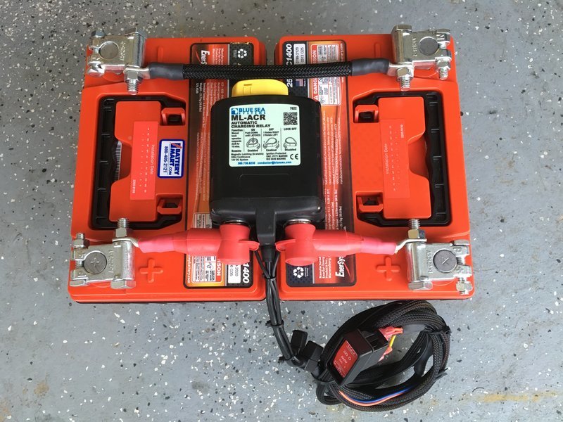

    So, as I am still awaiting my backordered group 35, I was considering adding the second in preparation for your completed dual battery tray setup. Should I make the second battery a group 25 then?
    I will describe the final setup I need in a PM. Thank you.
    ramonortiz55 likes this.
  18. Mar 27, 2016 at 12:45 PM
    #118
    HeliMedic
    HeliMedic [OP] Off-Grid Engineering
    Nov 12, 2010
    #46096
    616
    Erie, CO
    Constant revolving door of Toyota vehicles
    I would. I really like the fact that the terminals sit right across from each other. Here is my design for the dual battery setup with a Group 25/35 combo. When the tray is complete... this is how the kit will come:
  19. Mar 27, 2016 at 12:46 PM
    #119
    HeliMedic
    Nov 12, 2010
    #46096
    616
    Erie, CO
    There will, of course, be a tie-down that the relay is mounted to. Also, If you already have a 35/35 combo, don't worry... Ive got a clean design for that as well.
