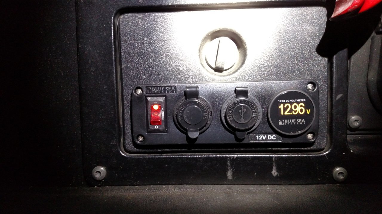

    I installed one of these in the cubby next to the power outlet in the bed, it has a cig outlet and usb ports: Blue Sea Blow Deck Panel

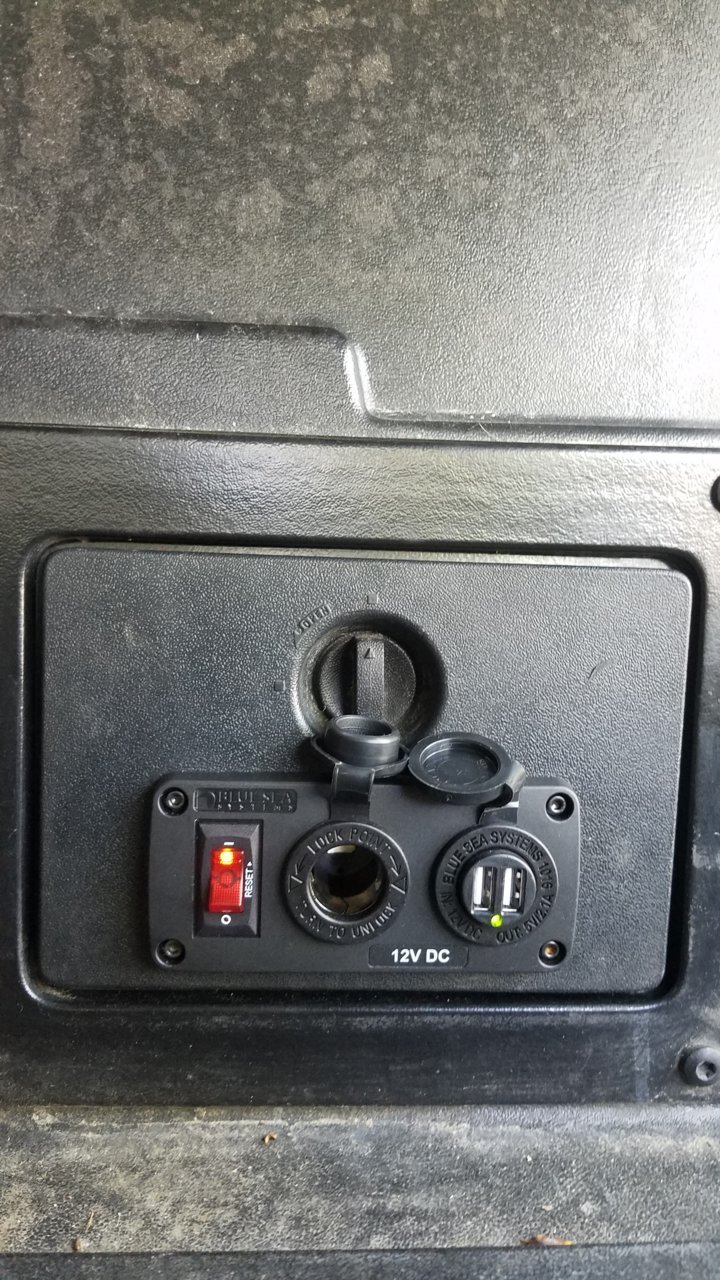

    I also installed a blue seas panel. My dometic is rated at close to 7.5a when running.

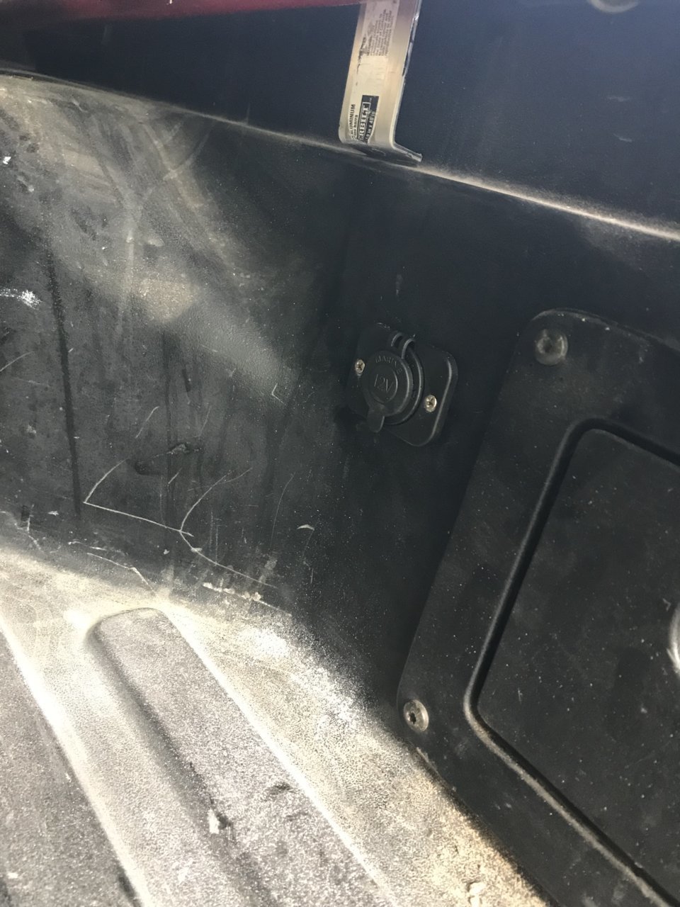

    So as you know, the fridge accepts both AC and DC. If you have both plugged in, the fridge defaults to AC. I leave both cables plugged into the fridge, and before I go on a trip, I'll run an extension cord to my truck and plug it into AC. That way it can get nice and chilled with no strain on the truck. Takes about 20 min to chill an empty fridge from 80 degrees to 36 degrees.
    It's impossible to name an exact number of how many amps the fridge will draw on average due to a lot of variables, but reading this article, they found that it averaged a draw of 2.3Ah to maintain 40 degrees in a CFX-50.
    https://expeditionportal.com/field-tested-dometic-cfx-50-fridgefreezer/
    I just ran 14 gauge wire directly off the battery with an inline 7.5A fuse to a basic 12v outlet. It came directly from China but was delivered in about 10 days. A 1" hole saw and a little dremel action and it fit nice and snug.
    https://www.amazon.com/gp/product/B0002KRC5Y/ref=oh_aui_detailpage_o08_s00?ie=UTF8&psc=1
