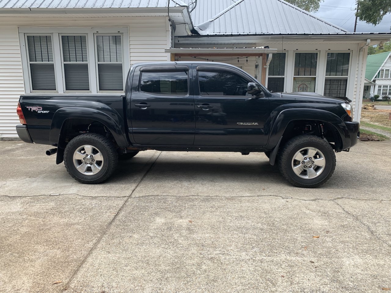

    Looking good there, even before tires! How much lift did you net front/rear?
  5. Oct 7, 2019 at 4:05 PM
    #165
    trdtacojef
    trdtacojef Well-Known Member
    Sep 4, 2019
    #304271
    287
    Jeremy
    Alabama
    2007 DCSB TRD Sport
    OME Dakar Medium duty rear leafs Total Choas UCAs Elka 2.5” Extended Travel CO and Rear Shocks w/ RR and DC FN FX Pro 17” Silver Rims Nitto Ridge Grapplers 285/70R17
    I asked the guy to get me level and shoot for 2.5” of lift. Went from around 37” to the fender to 39.5”.

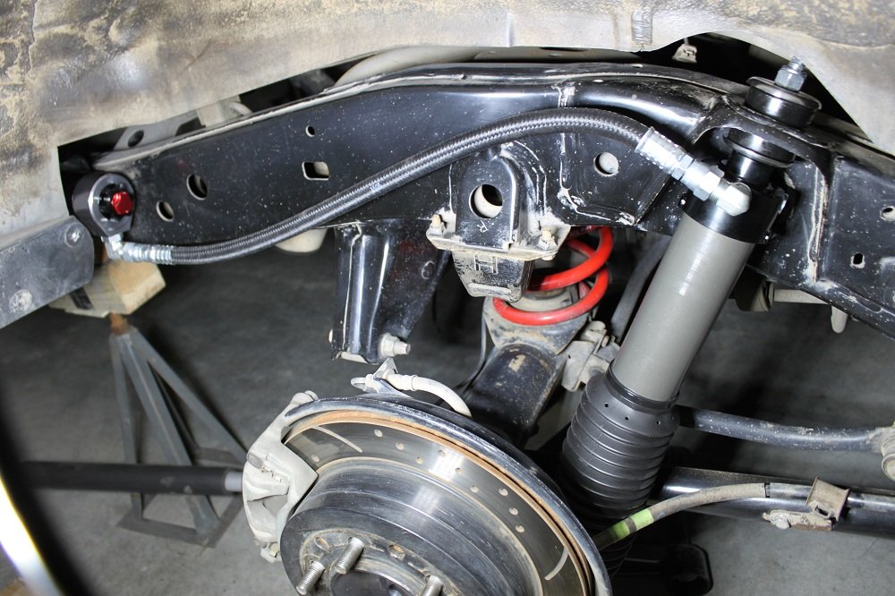

    So much better. I need to go drive!
    Front is way more planted/solid feeling, but not at all harsh.
    Less nose-dive and less throttle lifting.
    Less side to side wallowing feel.
    Happy camper, i am.
    Seems like on the T4Runner the rear resi clickers are going to get blasted with gravel/cinder.
    One little extra 'ear' on the back resi mounts and 2 bolts into the frame would hold the mounting bracket. I used 4 bolts and 2 large washer instead of the XL band clamp and custom taco bolts supplied.
    Noticed after install that the front resi hoses are not the same and the driver side rubs the shock mount.
    Will have to do some fine tuning.
  13. Oct 9, 2019 at 1:23 PM
    #173
    HeadStrong Off-Road
    HeadStrong Off-Road Well-Known Member Vendor
    May 28, 2015
    #156242
    4,035
    2011 Toyota Tacoma and 2019 4Runner
    Nice write up, feedback and photos!
