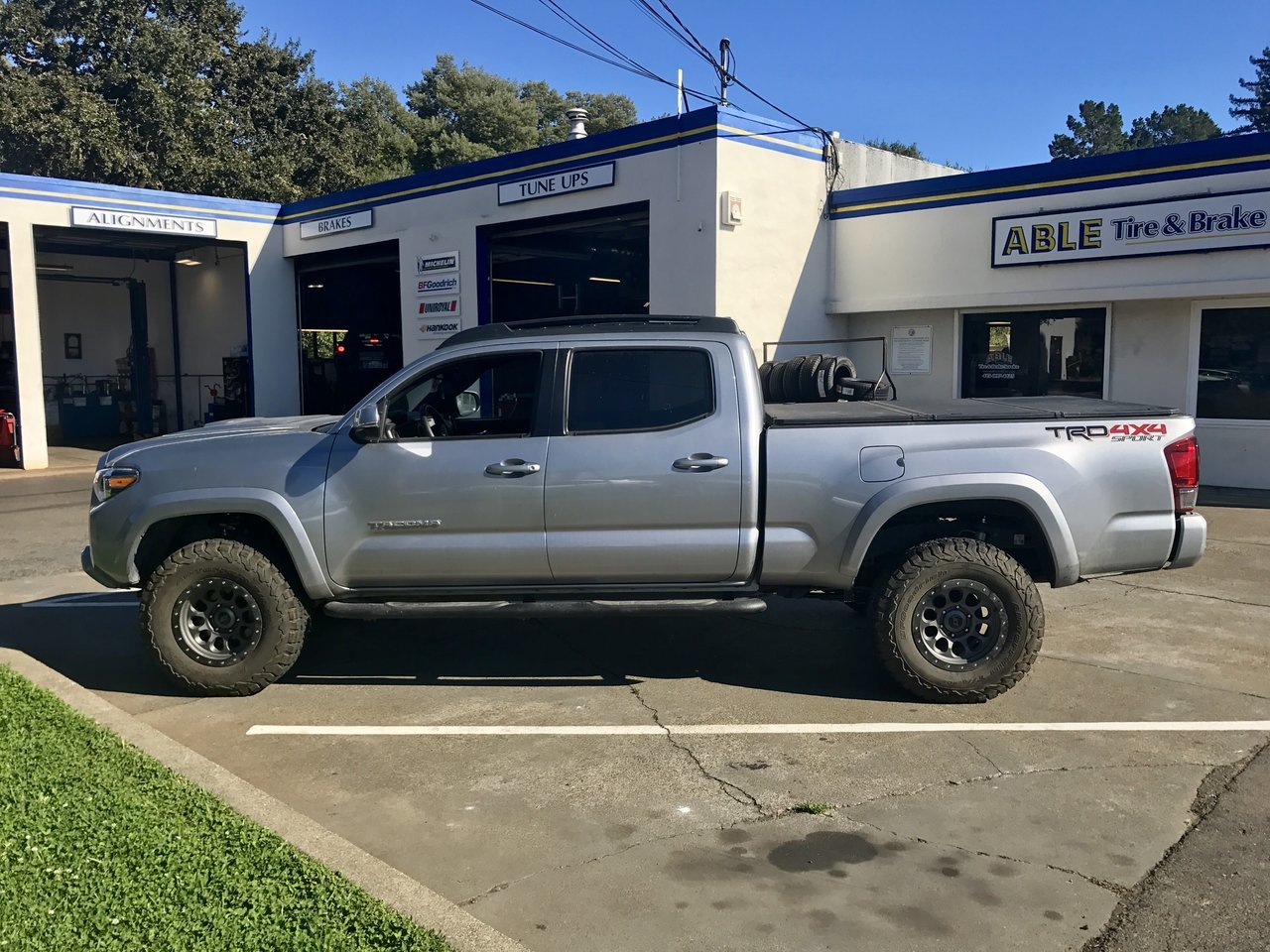

    Crappy pics, was too dirty during install. Great price on them, so much soother!!! Thanks again Jake!! Just an allingment then off to Nevada for a week!!!

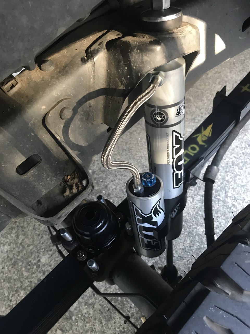

    I finally buttoned up the rear. Rides crazy smooth at high speeds on the rough roads. Thanks again for the GB Jake!

    Thanks dude, rear 2.0 resi with CD adjuster for 3-5" part number 985-26-118. They work great with the Dakar pack. Super droopy. I need to spin up the front coils about an inch to reduce the rake a little. I think it's like 2" higher in the rear right now.

    I got 2+ inches lift over stock in the rear. Only have 1" lift over stock on the front. I will turn up the coils in front another inch to get back to factory rake. I went with 2.0's in the rear because of the extra droop, and they will honestly be plenty cooling for me with the resi's in high speed off road. I'd definitely go with the part number ending in 118.

    Fox doesn't offer 3rd gen specific parts yet, it's all 05+... so I think it has to do with fox using 2nd gen measurements when saying for 3" -5". We 3rd gens have an inch over the 2nd gens, so it could be said that the 118's are really for 2-4" on the 3rd gens. Fox is also conservative on their measurements. In the end you give up just a tad of up travel for the extra droop - It just pairs better with the ride height and flex of the dakars. I did upgrade the bump stops as well, so I won't be bottoming out the shock and it's butter smooth when i do hit the stops.

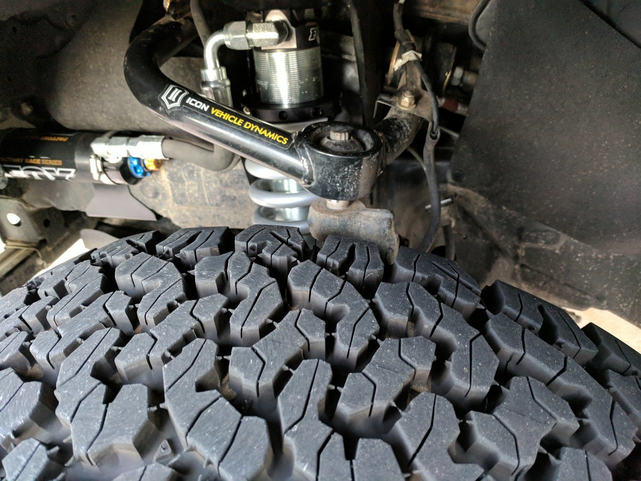

    not sure how old this post is but just a heads up on oyu guys might want to try and adjust those reservoirs a little more to have the hose different.
    I had mine like that originally and they rubbed on my wheels.
    Or at least check yours out at full lock how close you are.

    Thanks mate, no rubbing on mine though.

    Me neither, until I go 285s!!!
