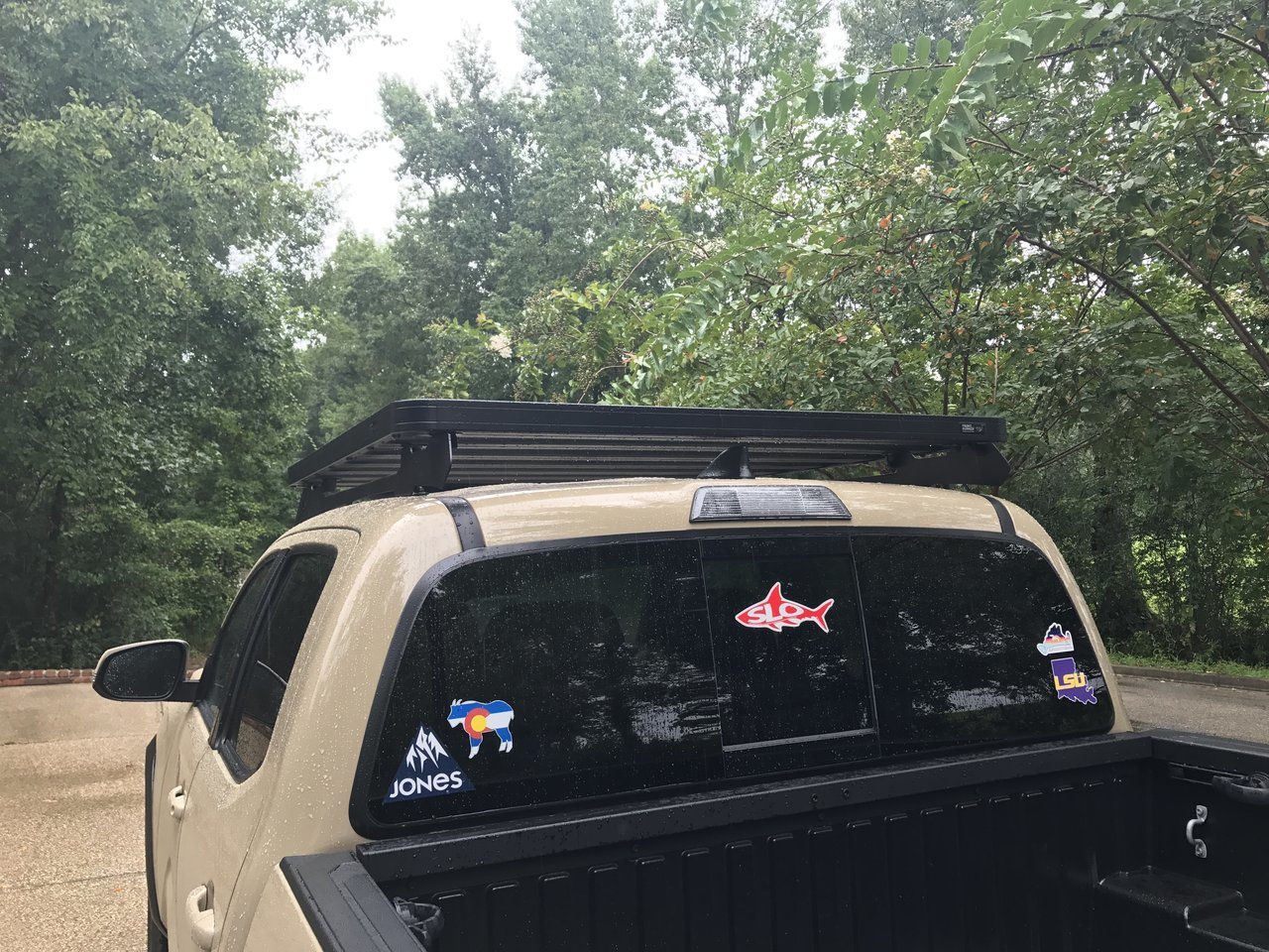

    I will say that prepare to spend at least 2.5 hours putting together just the rack because it takes a while to get the hang of juggling 4 foot long pieces of aluminum! Also these are very well made because they are VERY snug fitting.
    Will fully install tomorrow.

    Well, my factory holes were not lining up with the railings and spacers so I took it to a local toyota dealer to fix the factory hole issue and had them install for me. Now any leaking/issues should be warrantied by the dealer, although I did have to cough up a little money it was worth me not screwing up a 40k vehicle. Also all of the technicians, who had never seen a frontrunner really liked the look and said I'm ready for a safari haha.

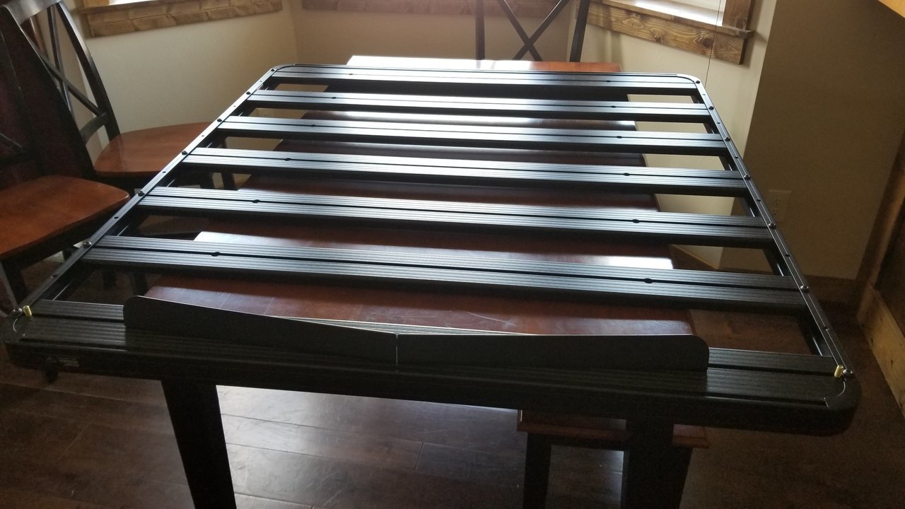

    Rack built. Took an hour from unbox to complete. Hate picture instructions. LoL
    The bolt heads are inconsistently 5mm. My own 5mm Allen wrench and the one provided by FR fit some bolt heads easier than others. Take your time do you don't strip the heads out.
    Also, read carefully. You need to insert a bolt into the T-slot BEFORE you mount the wind deflector. Instructions say to insert a nut. However, the install guide for the roof rack get clearly show a bolt.
    One the deflector is mounted you can't drlp the bolt into the slot. See cross bar at bottom of photo for reference.

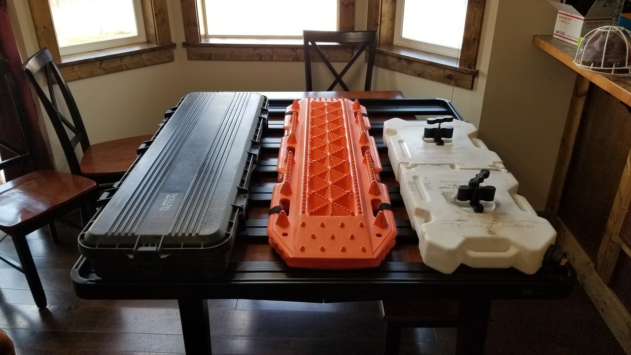

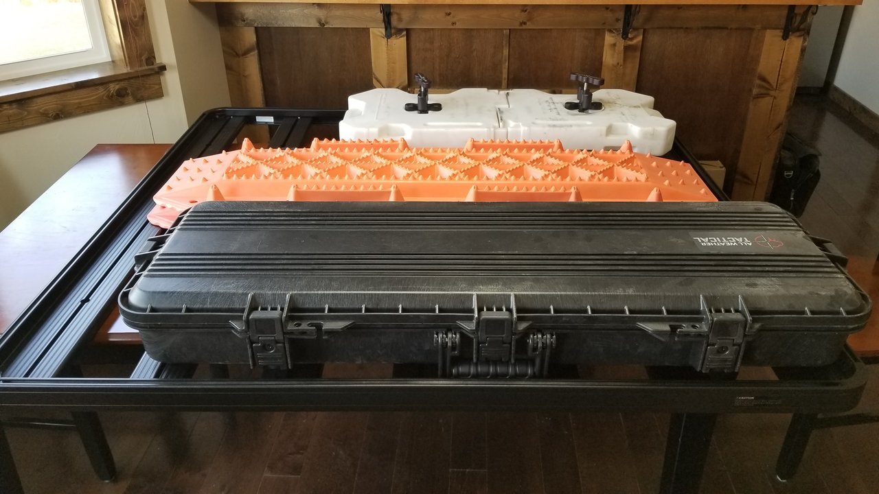

    Mock up for final install. Just waiting on my 22mm punch to arrive Tuesday. Nobody local had one. Had to hit Amazon.
    Rifle case holds my recovery gear. Has two built in locks. I'll be drilling holes in the bottom for bolts. Then will use large washers and bolts inside it to secure. The Escaper Buddy traction boards will get held in place using FR eye bolts. And once on the truck ill mount threw hilift jack mount along the edge.
    Rotox can double stack thanks to my Rotopax handles.

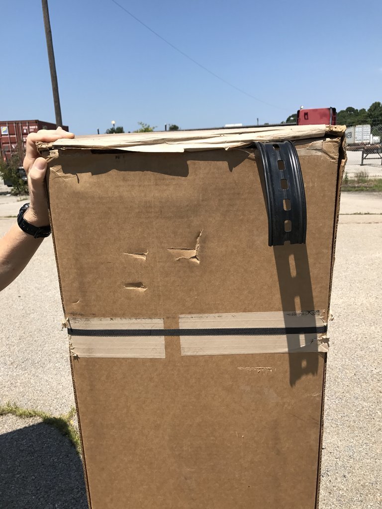

    Mine showed up today. Hope it's in good shape. This was hanging out of the box. Not the arm. The rubber piece. I will check it out tonight IMG_1292.jpg

    What the hell is that? Mine had no rubber stuff in the box.

    I have a rack for a cap. What's hanging out is the rubber gasket for the track that mounts to the cap.
    Check out the Prinsu Access cab mounting thread to see how to punch holes in the weather stripping. There is a metal strip running through the strips.
