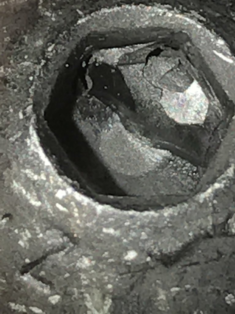

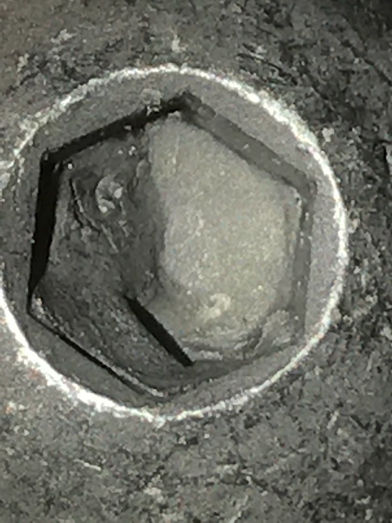

    Started to assemble my rack today. Things were going great till I started to install the M8 button head bolts. Couldn't get my Allen wrench into the head of the bolt. Here's why. About half a dozen bolts are crap. Anyone else having this issue. Shouldn't have this on a rack that costs a grand. IMG_1361.jpgIMG_1363.jpg

    Several of us had this issue.

    Really sucks. I'm gonna replace them. Anyone tell Front Runner?

    Do that for sure, brought my assembly to a screeching halt.

    I couldn't get the hex key into a couple of bolts at all.

    Yeah your bolt heads looked f***ed.
