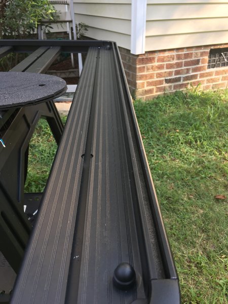

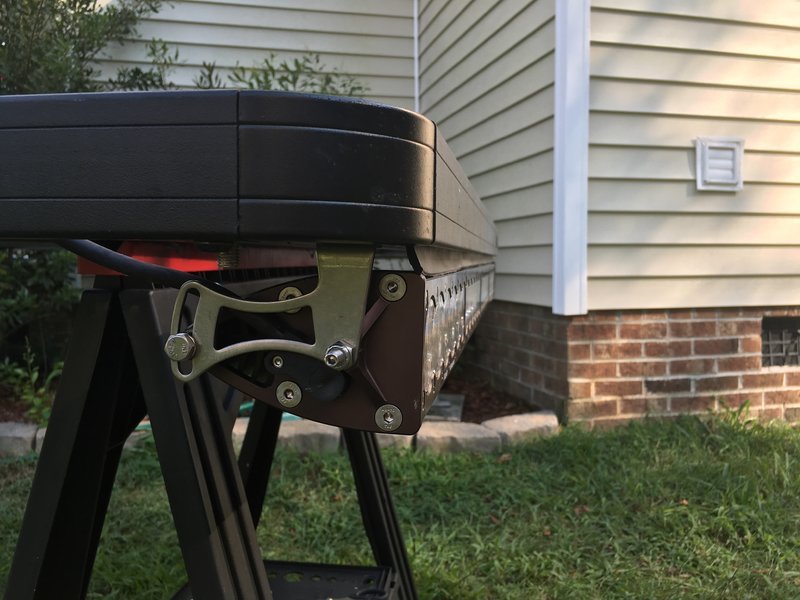

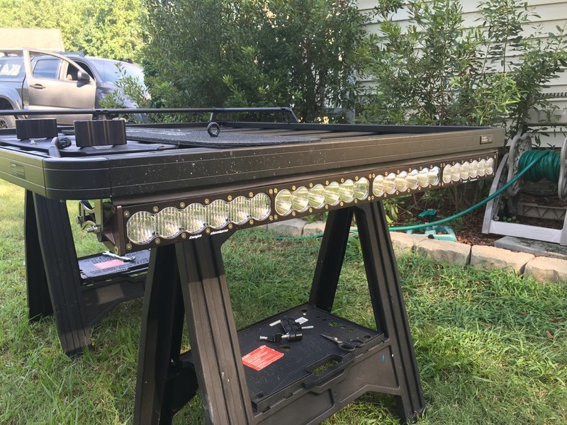

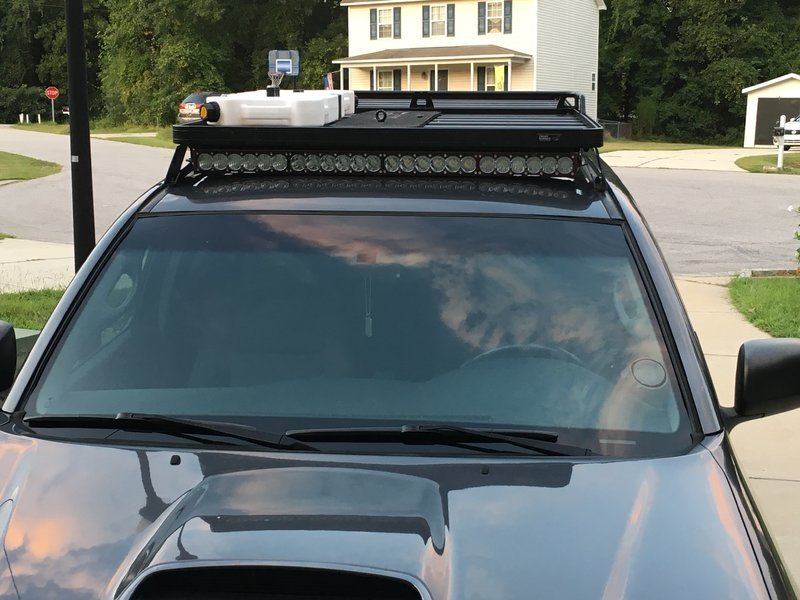

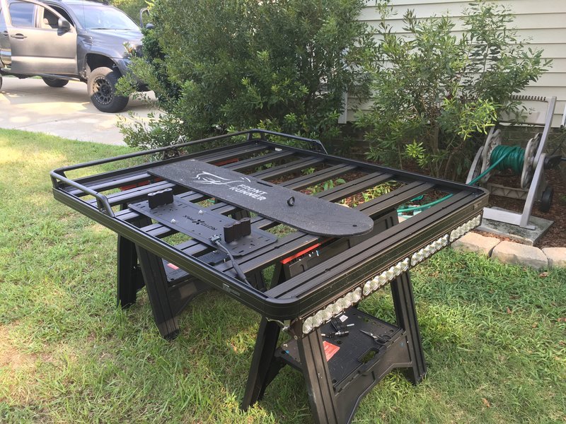

    Total Chaos +2" Long Travel Kit; King/TC 2.5 LT C/O w/ 16"x600; TC/CVJ Extended Axles; TC Spindle Gussets; King 2.5 RR shocks; All-Pro Expendition Leaf Pack; Pelfreybilt Sliders; Anti-Dark LED Hood Light mod; LED map and dome light mod; Bed lights; TRD Cold Air Intake; KB Voodoo Tailgate cap system; HomerTaco Thin Lip "Raptor" grille; sPod SE System w/ LCD Touchscreen; Baja Design OnX6 40"; Baja Design S2; Rigid Industries LED Rock Lights; Front Runner Slimline II Roof Rack; A.R.E. Z Series Camper Shell Projector BHLM Headlights (with custom wiring); Method Racing NVs 17"x 8.5; and Nitto Terra Grappers 265/60/17
    Ok, so your lucky, I have mounted almost everything you are talking about. mounting anything on a frontrunner, you will have to go buy Grade 8 bolts and nuts (or anything you like to hold things down). They have a lot of accessories that come with supplied nuts and bolts, with extra that I use sometimes too.
    Light Bar - I orginially had it on the front lip of the rack itself. there on slots you slide bolts into in order to mount stuff. I then when to what I have now, I drilled thru the first cross bracket of the rack and inserted a bolt through the bottom to a nut on top. Then I had a few caps left over from of accessories I have from them and caped the nuts. I had to purchase the right size and length of nut and bolt.
    MAXTRAX - Front Runner does not sell a bracket for MAXTRAX, but if the bolts that come with MAXTRAX slide into the slots that are on the cross bars then use those. I have front runner's sand lizard rescue traxs on my rack, then will be placing MAXTRAXs or something on top of those.
    Pelican Boxes - Go buy a few bolts that will slide into the tracks on the cross bars. Drill holes in the pelican cases and slide the case over the bolts that are sticking up from the rack. then simply screw on the bolts to hold it down.
    That help. I'm plan on doing a write up on mounting light bars or things to the racks, once I get a minute to set down and do it.

    In the first picture, the black bolt nuts, those are the ones for your light bar brackets, correct?
