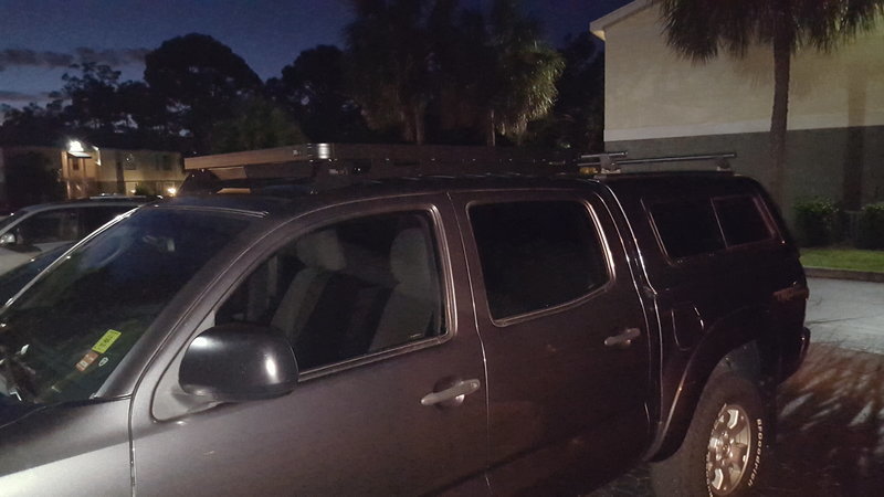

    Install of the cab rack done. 4 hours and lots of learning on the go(and cursing). The canopy should go smooth now.
    I used normal clear silcone for bathrooms and the like, worked great waterproofing the canopy.
    Ill post a better pic in the daytime.
