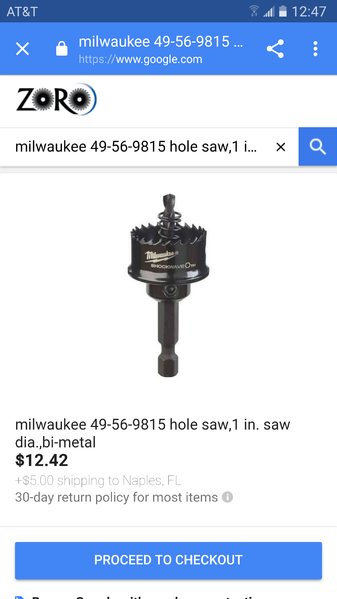

    To all of thos having trouble with the rubber. I used a 7/8ths hole saw bit that also had a drill bit attached to keep the saw centered. A friend helped hold the rubber still and my holes turned out great. I did have to make some slightly bigger with a utility knife to get appropriate allignment with the anchor points in the roof, but nothing crazy. Take your time with measurement, the rubbers are a bitch, but it is doable.
    Like this, but 7/8ths

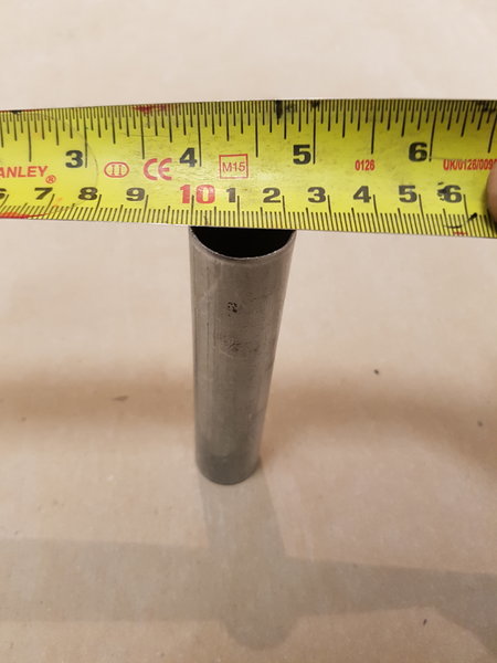

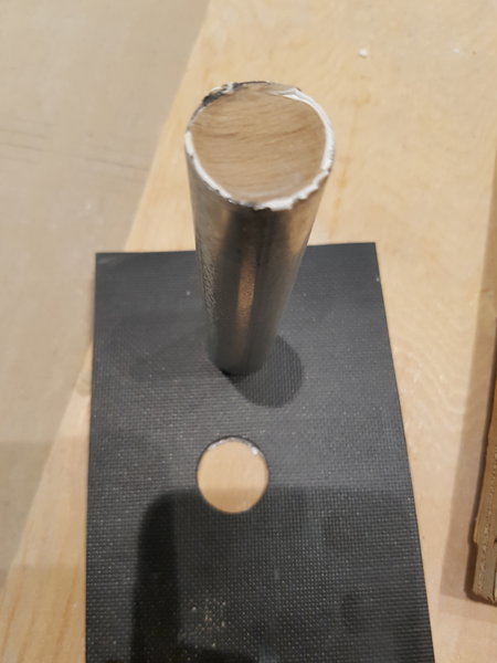

    DIY Leather hole punch.
    Took a short piece of 3/4 EMT conduit, sharpened the inside with a step bit and filed the outside.
    Tried it on a piece of hard vinyl flooring and it worked wonderfully. Won't be installing my rack for another two weeks or so but I think this will work just fine as a punch for the ditch mouldings.

    Yeah I saw this at HomeDepot AFTER I already mucked mine up.

    I ordered the punch from Amazon. Says it will arrive in November so I'll try the diy if I get too antsy.
