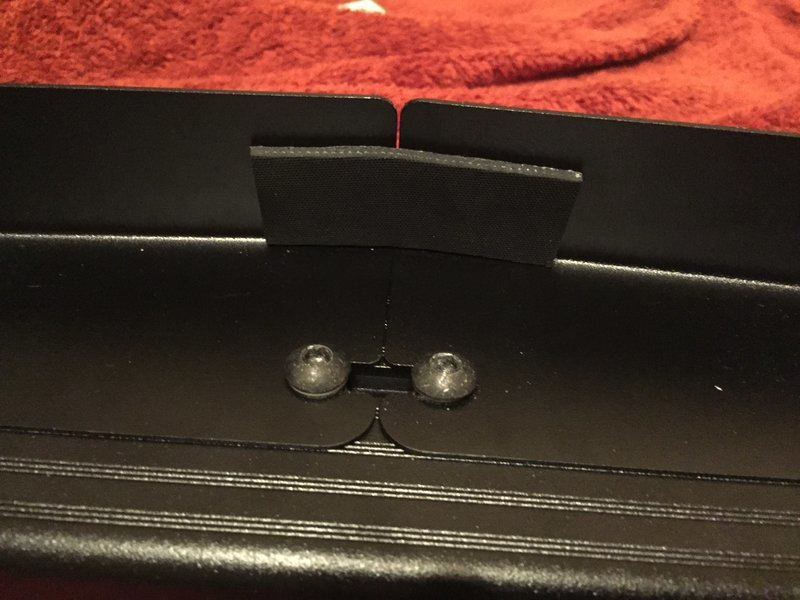

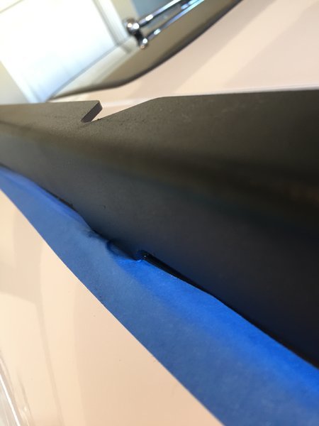

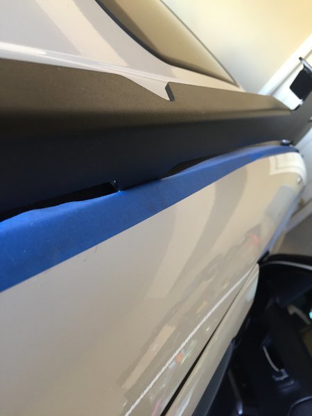

    Install is finally complete I did notice my rails were actually grinding on my paint in the channel. The middle mounting points tore thru the masking tape and straight into my paint. I called front runner and they suggested to just add washers on the middle spacer. As for the whistle some guys are experiencing...he said the rubbers pieces are actually used to make the wind deflector one piece. Drove down the road and no whistle from 0mph-80mph (See pics below)image.jpgimage.jpgimage.jpg

    Interesting about the rubber pieces. Per the packages instructions, that's not what they are used for.

    Yea the front runner rep I spoke to said they don't ever look at the instructions to put the tray together. It was his first time seeing the instructions for the Tacoma and he seemed dumbfounded when he read to put the rubber pieces between the tray and deflector.

    My rack is hitting the paint also. I tried adding some washers but that didn't work for me. Were you able to resolve this issue?
