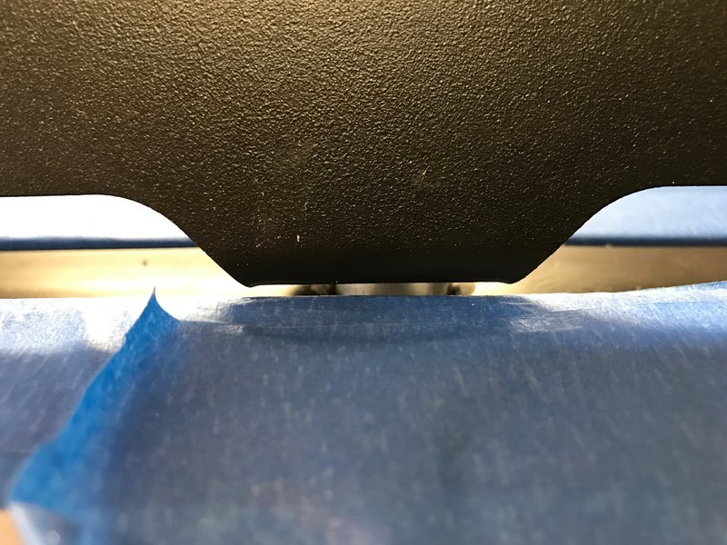

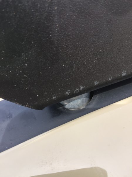

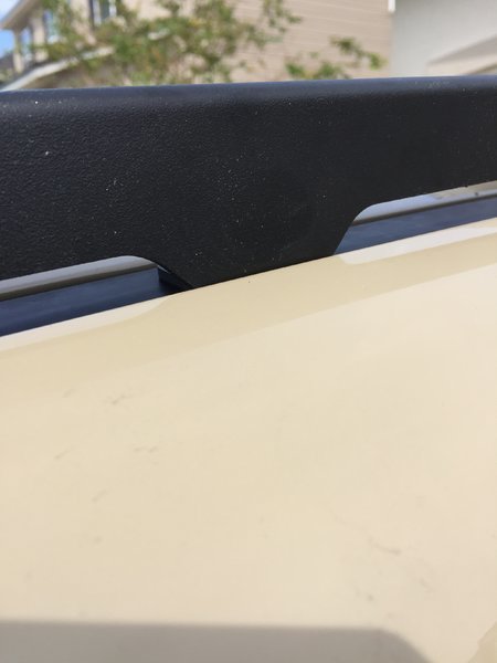

    Just installed the rails. Had to buy new bolts due to the ones from Front Runner being too short. I called Front Runner and was told "those are the correct bolts" and talked to an installer. I was told to just wiggle the rails around and eventually it goes in. I explained to them that the height of the spacer + lock washer + washer + rail is over 35mm, and no amount of "wiggling" would make it work. Ultimately had to buy 40mm bolts to get the front and back installed (the center is fine) A little pissed off with their customer service team at the moment.
    The hole punch was invaluable and made the job easier. I still have a gap around my spacers though?
    The only other problem I have is the middle portion of the rack touches the paint, and no amount of pushed and adjusting will make it work.

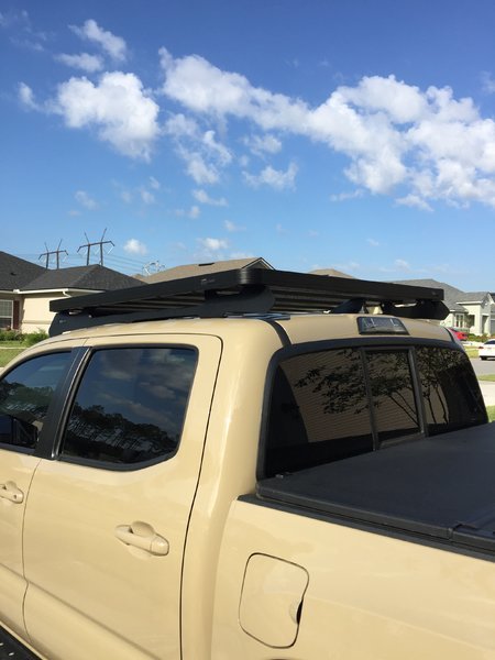

    Got it fully installed. The instructions were a bit worthless at some points.
    Took it for a test drive and the only whistle I have is between 30-35mph. Had it up to 65 and no whistle. I'll test it on the highway tomorrow.

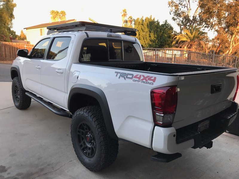

    I had the same issue with the middle mounting points contacting the paint. The problem is the middle spacers are to short, if I would have been sent all tall spacers I don't think I would have ran into this issue. I was able to gain some clearance by adding 2 washers to the middle spacers on both the passenger and driver side. I'll post a pic of the clearance I now have.
    The rack is now fully installed and looks awesome! Cant wait for my shell to get here to throw on the canopy rack.

    I originally had an issue but Frontrunner shipped taller spaces within a few days of me notifying them of the issue. Taller spacers fixed it!

    They shouldn't be. The middle are shorter than the front and back.
    Front and back are close to 3/4" tall, the middle should be 1/2" (if I remember correctly, might be wrong).
