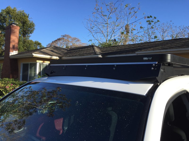

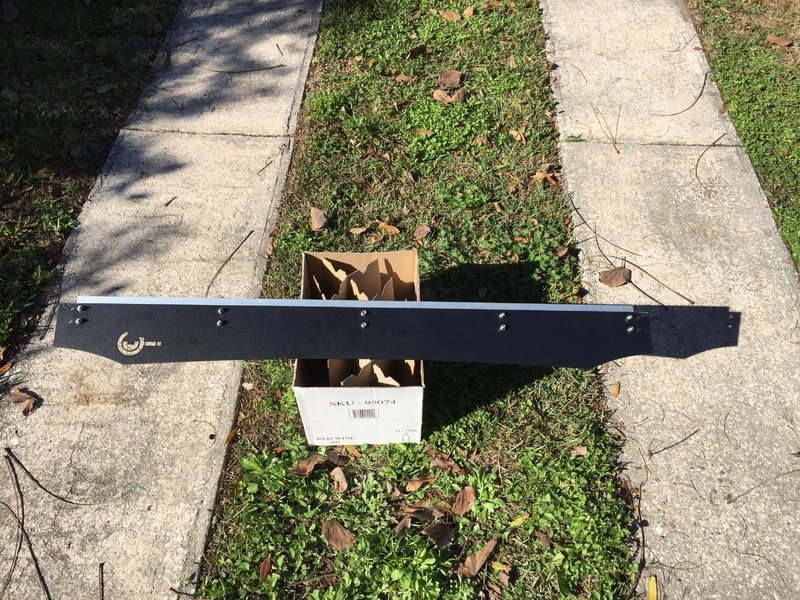

    Prinsu wind fairing has been installed. The fairing does not come into contact with the roof of the cab (which is how I wanted it). I know it looks unfinished and it is, I just have a slight whistle to attend to and a few hardware bits to figure out and it will be complete!

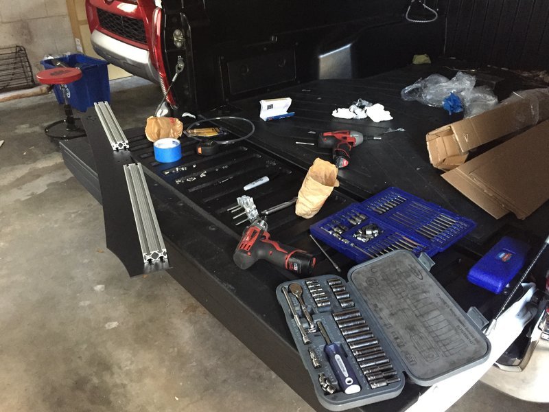

  11. Feb 25, 2017 at 7:32 PM
    #1271
    12Mk6gti
    12Mk6gti Well-Known Member
    Jun 23, 2013
    #106876
    221
    Scott
    Sunshine state
    2019 Nautical Blue TRD OffRoad 4Runner

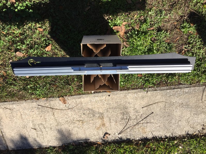

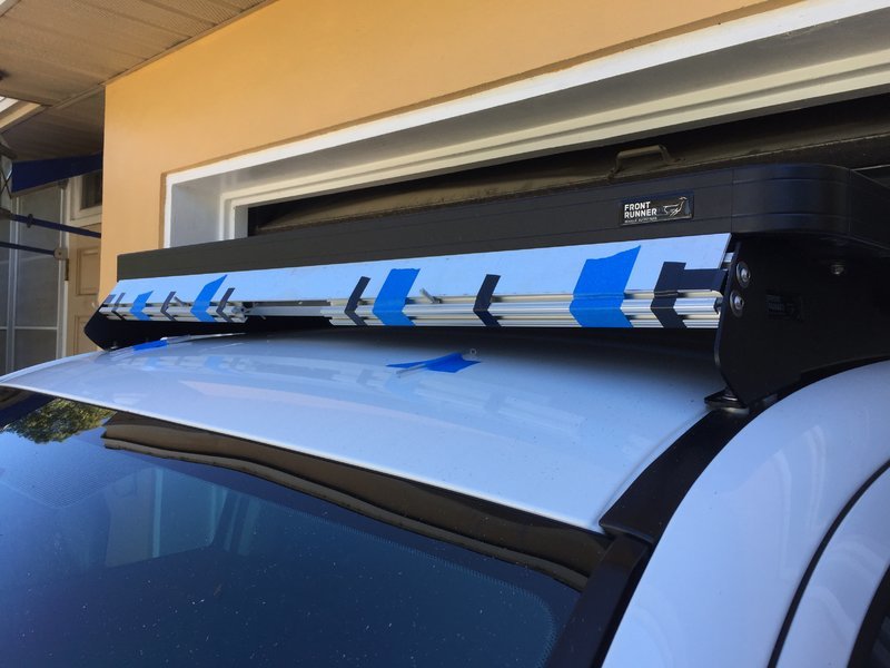

    Here are 2 pictures of the backside showing the mounting brackets. I added a 1"X1" piece of aluminum angle to brace the middle section for now so it would keep the fairing from bowing. I had to cut the 25mmx50mm aluminum extrusion so I could make smaller sized brackets to mark my drill points in the front runner siderails. I will post those pictures tomorrow when I have the fairing off.
    Kumunoy likes this.

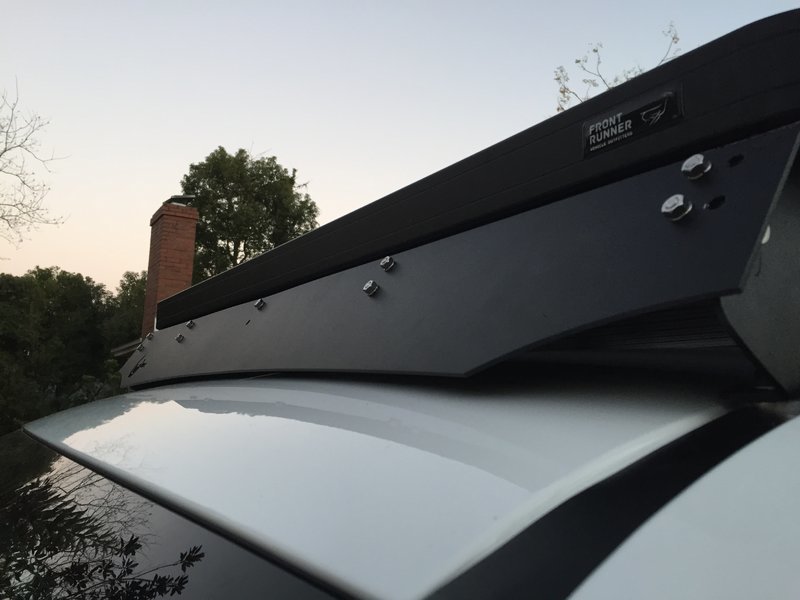

    I removed the fairing and made a trip to get a new blade for our miter saw. The diablo blade kicks ass at cutting aluminum! On the way to homedepot I jumped on the interstate to see what would happen without any sort of wind deflector. It was a little quieter than having the airdam installed and there was a loud whistle noise. Those were the only 2 things I noticed.. I finished modifying my fairing for now. No more whistle at all. Haven't had a chance to take it up to highway speed yet! I don't really like the bare aluminum look so I may have it powder coated at a later time...

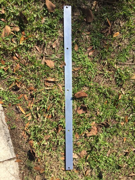

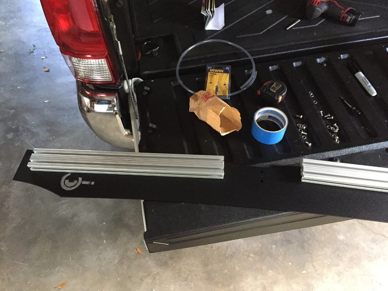

    More pictures

    Wind noise has been decreased by at least 75% while driving at 70mph! I can hear the roof rack making the same amount of noise as the exterior side mirrors it seems. No mpg to report yet!
