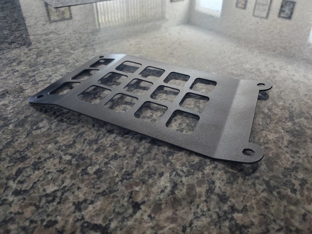

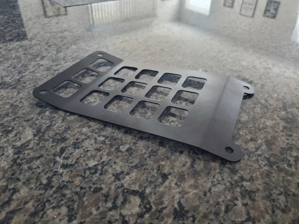

    So, I don't own a 3rd Gen at all.
    I was fortunate enough that @musicisevil had that plastic panel shipped to me as I used it to mock up that molle panel.
    Molle is standardized, but unfortunately many accessories and panels aren't centered around that exact standard - some have as much as a 1" gap between the slots, others as little as 1/8".
    I know it's not what you asked, but thought I'd share that information.
    With that said, I would like to see this get installed first before I commit to making more.
    I did make one for another member as well @MagicToolbox so the both of them would help to determine if the panel I made will suffice or not.
    If I get the thumbs up from both of them, I'll make more and you'll be on that list.
    I made myself one to keep as a "master" in the event that I do make more for people in the future.
    As for hardware, well that goes back to the not owning a Tacoma.
    I wouldn't know exactly what spacing would be "just right" but maybe 4 delrin spacers, 4 nuts and 4 bolts.
    If enough people want one, I may buy the parts in bulk and offer hardware with the panels.

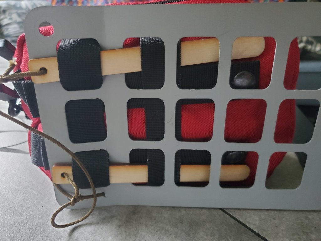

    It might have been mine. I'm about to go out but my first attempts with my laser cut plywood version have a pair of basically tongue depressers with a piece of utility cord tied on. Pull the utility cord up and the FAK falls off. Easy deploy, but a little more complicated to put it back in place.
    musicisevil likes this.

    It definitely was yours…:frusty: You and kwiq always seem to reply to my dumb posts before i can delete or edit them!
    This is absolutely brilliant by the way! I’ve never seen anything like it. I was emulating this with rigid plastic card scrap that I have when I destroyed my paint (pics later today) figuring out how to attach a sheath with a leather belt loop. Would a thinner stick make things easier? It’s probably that the fabric doesn’t have enough give though huh? Would running them horizontally though the straps make it easier to install the bag back on the panel since they are a little bit more slack than the stiched horizontals?

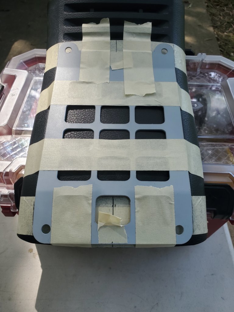

    So after taking pictures yesterday, I got impatient and mounted the panel with hardware I had sitting around. I messed up the paint because it wasn’t fully dry, and tried to use an automotive touch up pen on it. The paint bubbled up like the stuff was paint thinner so I need to go through that whole song and dance again, with the addition of clear coat this time.
    ^This is the clearence with 1/2” of nylon spacers.
    ^I just eyeballed the mounting holes, lining up the panel and marking the holes hastily. Fit is fine, a bit crooked, but to my benefit because I managed to clear the little fin that usually needs to be trimmed.
    ^My planned use for this panel was to replace this sketchy mount I rigged up when I gave up on sourcing the original piece.
    The belt clip is compatible with molle webbing, but the slot is too narrow for use here. I would have happily widened this to fit the kwikfab panel, but my wife saw me playing with “her knife” and decided she wants it back in her ride.
    One less project.
    ^The spacing works just fine with this triple strap bag I have. However with 1/2” spacers, there still isn’t much room to slide the snaps under the bottom of rows 2 & 3. Could have pushed it through with a tiny bit of effort, it was just snug. No issues with clearing the bottom of row 4.
    ^New truck knife sheath is leather and I was toying with @MagicToolbox quick release stix when I messed up the paint. Here is the clearence with 5 or 6/16” spacers. Since I’m not mounting a bag I may reduce the spacer height from 1/2” to whatever allows the panel to not touch in the middle.
    When folding up the rear seat, the seat bottoms touch the rear of the center console.
    I have the 40% (drivers side) seat bottom removed in mine and seldom fold the rear flat, but that clearance with this panel installed is definitely something to keep in mind. I’ll add pics with the seats folded after it’s re-painted.

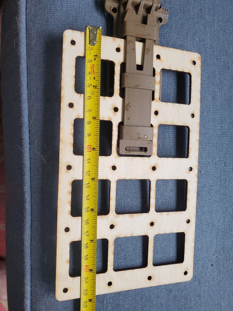

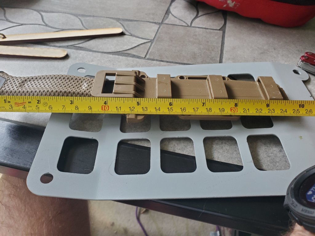

    I got a chance to play trucks today for a little bit before it started raining. I started by getting it mounted rather than test fitting the Gerber molle mount knife I have (because I'm a moron, shut up - that's why.) So after careful layout, and a little moving around to avoid that one plastic web, I got it in place. 20240901_115715.jpg
    The Hazzard Fraught transfer punch set I bought for the hidden stiffys mount let me make center punch marks.
    I have a riv-nut tool and some M-6 riv-nut so I drilled holes for those. I should have ordered the larger type of riv-nut that is better for plastic, they expand more, I'm worried these will pull through. A quick run to the hardware store for M-6 bolts and things were looking good.

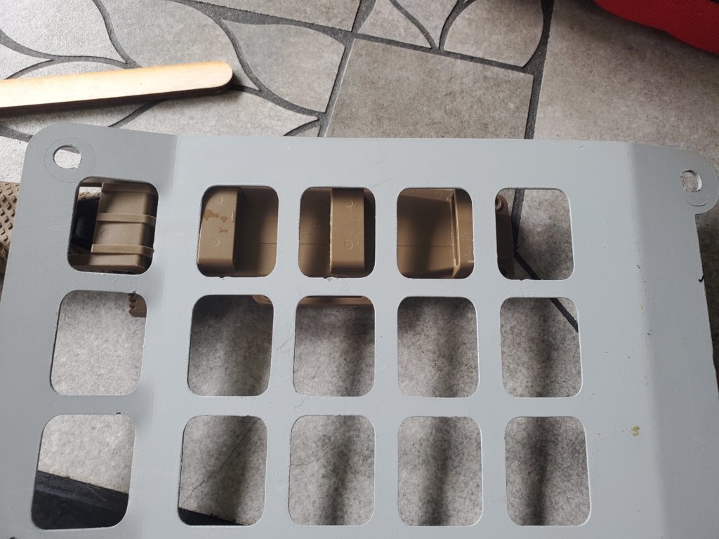

    Then I started to mount my FAK. I think the pitch on the holes is wrong (top to bottom) for the two things I have to mount.
    I did some Googleing, and found this "reference":
    Which is what I used for my laser cut prototype. (Although I made my cutouts a little larger to ease strap insertion.)
    There is no way to get this Gerber knife mounted to this panel.
    Putting the tape on the knife it looks like they used a pitch of 1.75“.
    I think there is a range of different dimensions used in molle so it may be that some things will work better than others.

    Yep, I think I said it here or via PM to someone but that many accessories do not follow the standard molle configuration.
    I don't believe the IFAK I have (the one found on Amazon) is even made to work.
    You want to send me your CAD file and I'll make another? I've got plenty of 16 gauge as I just bought a 4' x 8' last week.
