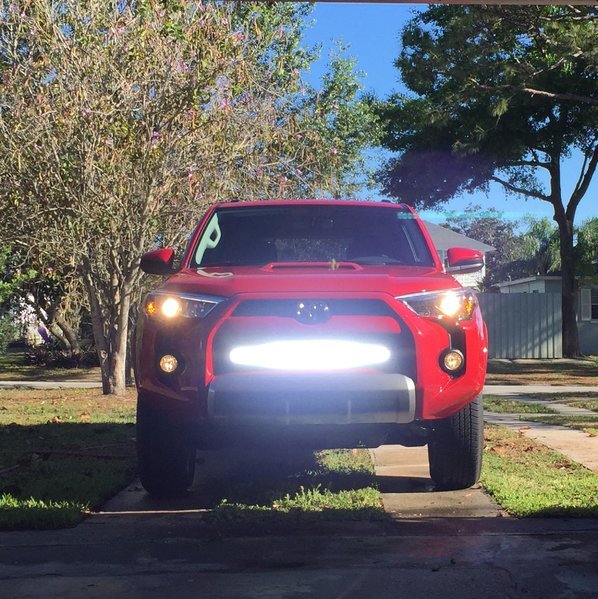

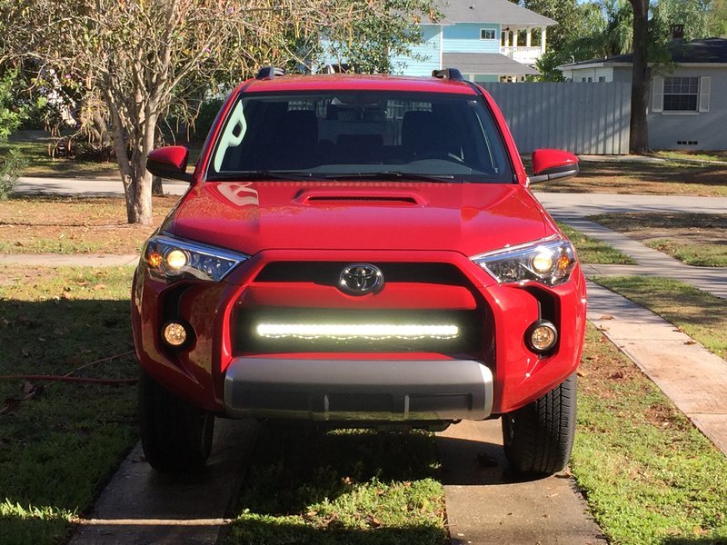

    Better picture after cutting out part of the lower grille.

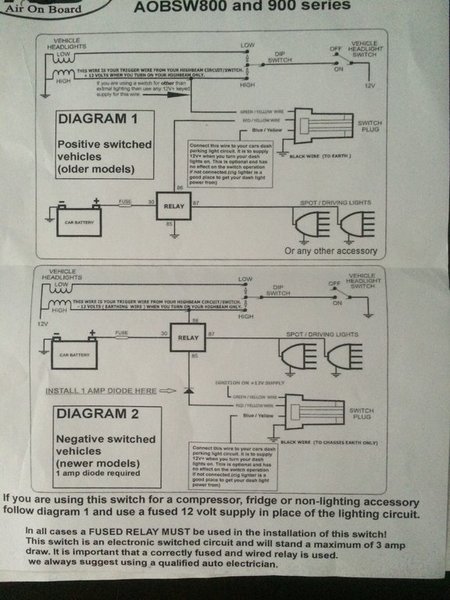

    Anyone got any ideas on how to wire these up to AOB switches. I tired to match the wiring diagrams but its not happening in my head. 4 wires coming out of the AOB, 3 from the harness on the light I got.

    Is the 4th wire for switch illumination? That's how it was on my MicTuning switches.

    I think so but

    AOB Switch Wires;
    Black - Connect to gray factory wire (- dimming) outlined in link
    Blue - Connect to green factory wire (+) outlined in link
    Red - Connect to relay trigger wire (power out of switch to relay when switch is engaged/turned on)
    Green - Connect to hot lead from relay (power into switch)

    Perfect thanks

    The 4th wire on my ch4x4 switch is for illumination!

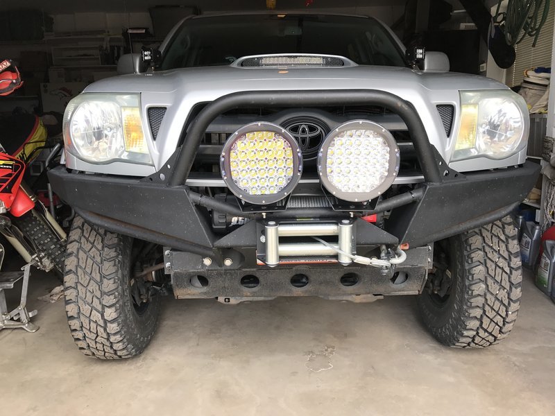

    Finally got em mounted and wired up. Will have to wait until tonight to aim them and get some illumination pics. IMG_6617.jpg

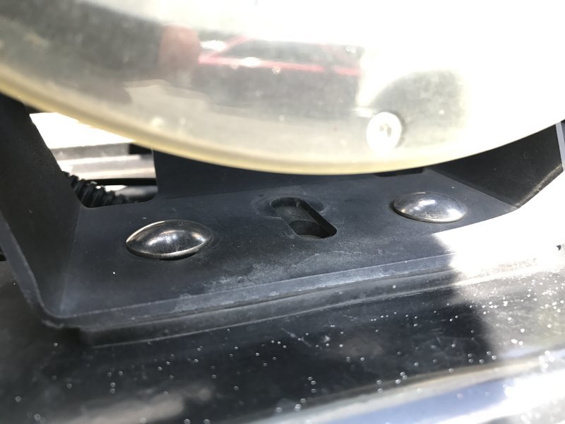

    @Iggy are yours mounted with the single bolt or were you able to utilize all 3 mounting bolts?

    I use 2. Three is really not needed and 1 in the center will work, but if you hit washboards with any enthusiasm the lights move.
