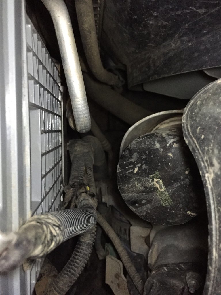

    For those putting the 31M in the Pelfreybilt tray on a 2nd gen. You WILL have to extend your positive cable.

    I lied.....
    Cut the electrical tape holding the wire in the engine harness and pull it out a bit onto the side of the battery. dbcbd72b90c9ca342e919f1670478c11_4ef697ef11057b9a57836fa11153c4b9e6ad2802.jpg

    BUT you definitely have to extend your fuse box wire that goes onto the positive terminal lol

    I'm not kidding with that one. It's literally an inch short

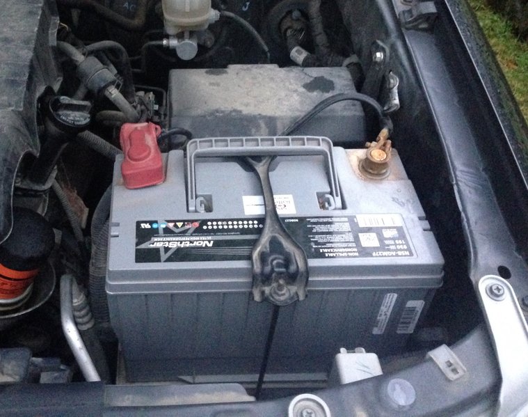

    Anyone else have trouble getting the tie down back on? I can't for the life of me get the damn thing back on.

    Did you go under the handle on the battery ?

    Like this ?

    You crafty Canadian! Thanks Oz!
