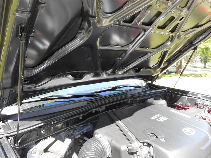

    Looking good bud, such a clean install, like it came off the assembly line!
