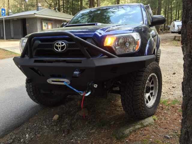

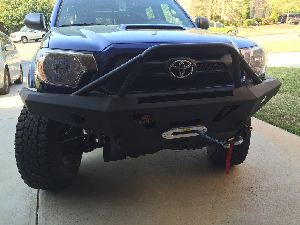

    The space between light mountis 1/8-1/4" too narrow and I can't get my LED bar between the mounts. I even tried pounding the mounts out wider, but they are welded at top and front and won't shift enough.

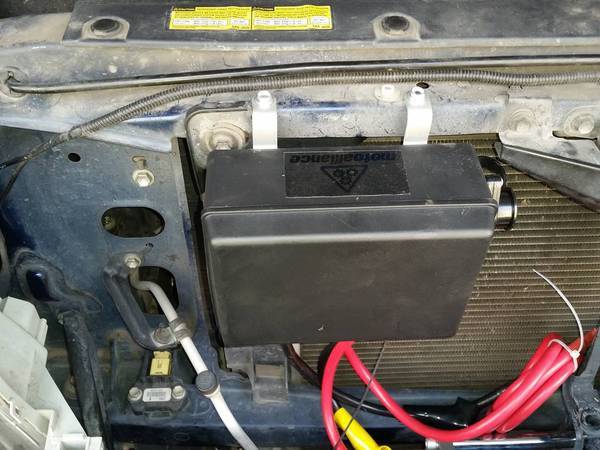

    I had to give up on the light bar. Not only are the mounts too narrow to fit the bar, but there is not enough space between the winch solenoid and the front of the bumper to wedge a light bar in there.
    Mounted everything else up and went camping Wed/Th with the family.

    It's one from AVEC here on TW. We discussed the specs in this thread (quoted above). I was just about to put a grinding wheel on my angle grinder and try taking about 1-2/16" off each end to see if it would fit when my wife mounted the solenoid on top of the winch and we realized there was no space left for the bar.
    I looked around for another mount location for the solenoid, but the cables that go to the winch engine are pretty short.

    Gravedgr,
    I know how much you would like to get that light bar inside your grill. I located my winch controller just behind my grille. See pic. Hope this will help you out. I had to switch my brackets on the controller 180 degrees around and drill a couple of holes to install it. I have the Viper Max 12000. With the controller relocated, all the wiring should still reach all your connection points. Hope this gives you some ideas..... Bumper looks awesome man!!!!!!!!
