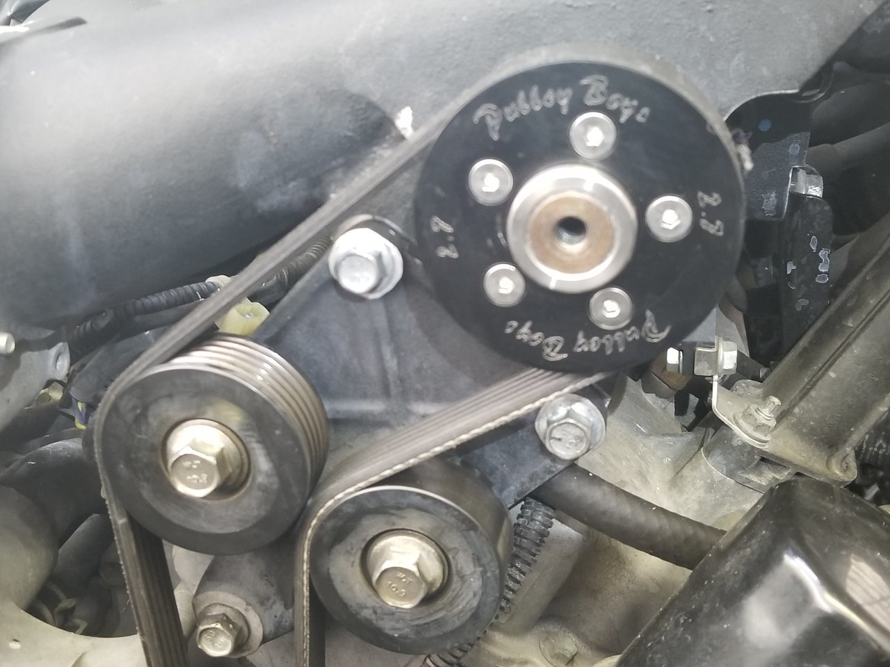

    I ended up doing the same stuff. Good arm workout today. Totally had to destroy the urd pulley to remove it as the thing bent so easily under the strain of the puller. Threw on the 2.5 pulley and a shorter belt.
    Noticed that the new pulley didn't seem to line up as nicely as the old one did with the idler pulleys so ended up using washers to space them out a bit so things line up better. Don't know if it's the best solution or if it would be better to try to push the pulley a little further up the shaft. IMG_20171130_144015.jpg

    I added a 3 washers behind the idler mounting plate and two washers behind the two pulleys to bump everything out about 3/16". My belt was overhanging my non ribbed idler by around an 1/8"

    The pic was a before washer pic. Just not sure if I'd prefer to jam the charger pulley a little further on the shaft and remove the washers I put in as a quick fix. My daily driver and had to pick up the kiddo so I made things work for now and no belts jumped off.

    I have talked about spacing out the idler pulley's to get everything a bit more centered by 1/8" previously. In my Qwikchange pulley thread.
    The only one I needed to space out was the smooth idler pulley. Not the ribbed one.

    I had to space both pulleys out.

    So, would you say that the new Pulley Boys hub should be pressed on to the shaft about 1/8” past the tip ?
    I’m thinking that spacing out the idlers is not really a good solution as we’re still mis-aligned with the crank pulley.

    The Pulleyboys hub adapter needs to be pressed in flush with the shaft. If you look at the hub adapter and the shaft when they are installed the surface should appear like a straight clean line.
    The only reason I spaced out my smooth idler was because I didnt like that the belt was riding at the edge of the idler. It was an insurance policy, nothing more nothing less.

    I am considering pushing the pulley further in as well for the same reason
