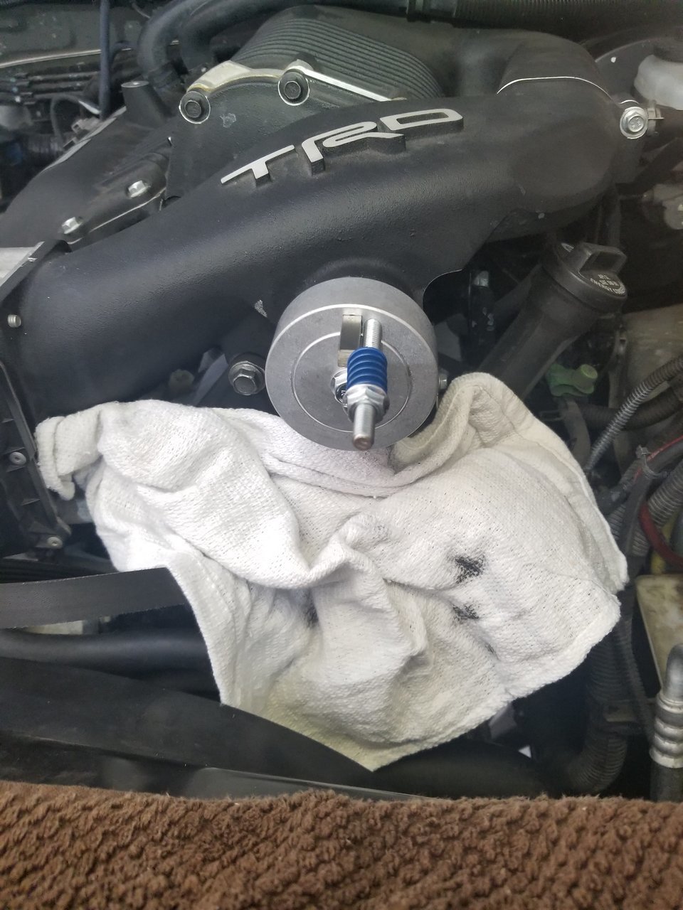

    Well, that’s alarming. So, you’re seeing differences in spacing between different size pulleys on the same hub?! That’s no bueno.
    As for yesterday’s activities in my driveway. I installed a 2.8 pulley and Grant installed a 2.5. We pressed both hubs to the same depth on both blowers. The belt lined up great on both trucks.
    We did however notice that his 2.5 pulley did not want to slide onto my hub. But my 2.5 pulley (I bought two sizes) slipped on very nice. His hub/pulley fit together very snugly. In fact, after pressing on the hub, we needed to chill the snout/hub to get his pulley to slip on.
    So, depth inconsistencies between the individual pulley sizes is an issue eh? Great :annoyed:

    Yup there inconsistencies between both pulleys. The 2.8 slides super easy onto the hub and the 2.6 needs to be perfectly aligned to slide on. I just measured the pulley thickness and there is a .007" height difference between the two. At the shop I work at we work to the .0001" so this deviation is actually a lot to my standards.
    I did some research earlier and according to Gates the rule of thumb for V-ribbed drives the total misalignment can be 1/16" per foot. Taking that into consideration the hub is unacceptable in the flush position but by pressing it further we are getting closer to the tolerance and the deviation between the pulleys should still be within tolerance assuming the crank pulley and idlers are at zero from TRD/Magnusons doing.

    Which is what Grant and I have done. We actually stopped about .010” short of the full depth that my modified press tool would have allowed. We saw that the back of the hub was about to contact that washer that is being retained by the snap ring. Hope that makes sense. So, in all actuality, we pressed them on about .175 beyond flush with the tip of the shaft.

    I measured the exposed shaft, the original pulley hub thickness, and the new hub adapter thickness and there should be about .250" of daylight between the original pulley and seal. (I am running a different seal so it might vary a few thousands.) So in theory we could push the adapter up to .250" before making contact and we are looking at about .159" so there should still be clearance between the hub and seal.

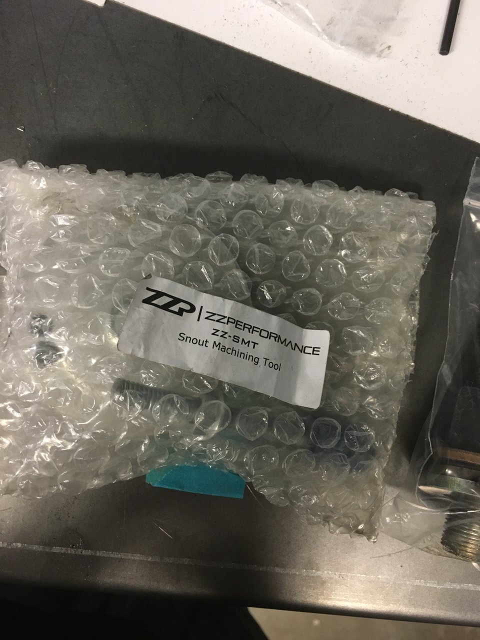

    So, before I go posting them in the marketplace; is anyone interested in:
    Snout cutter. $80 shipped to anywhere UPS goes in the continental US.

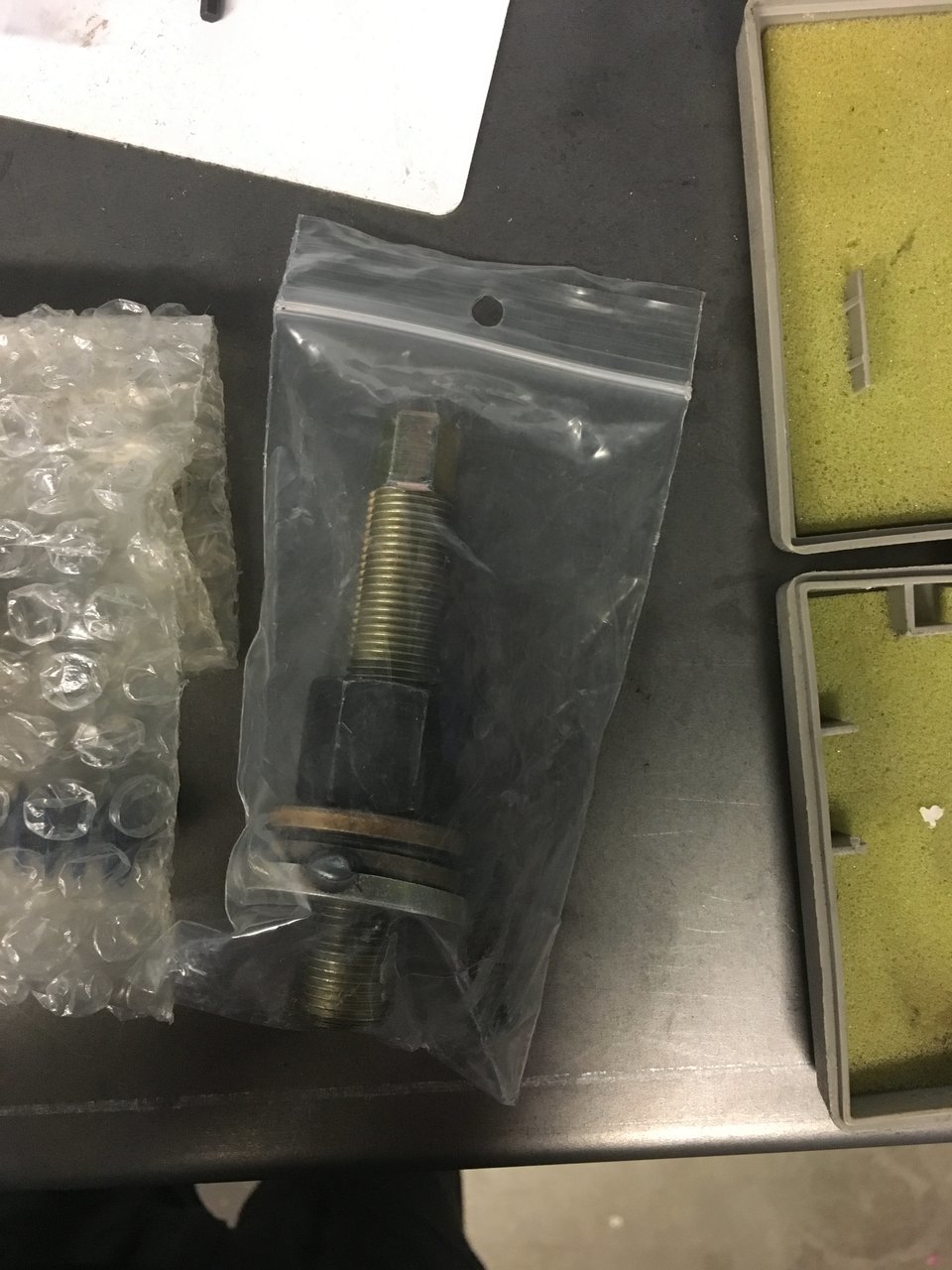

    Pulley press tool. $40 shipped to anywhere UPS goes in the continental US. Can be used for flush mounting the URD pulley as well as the PulleyBoys hub.

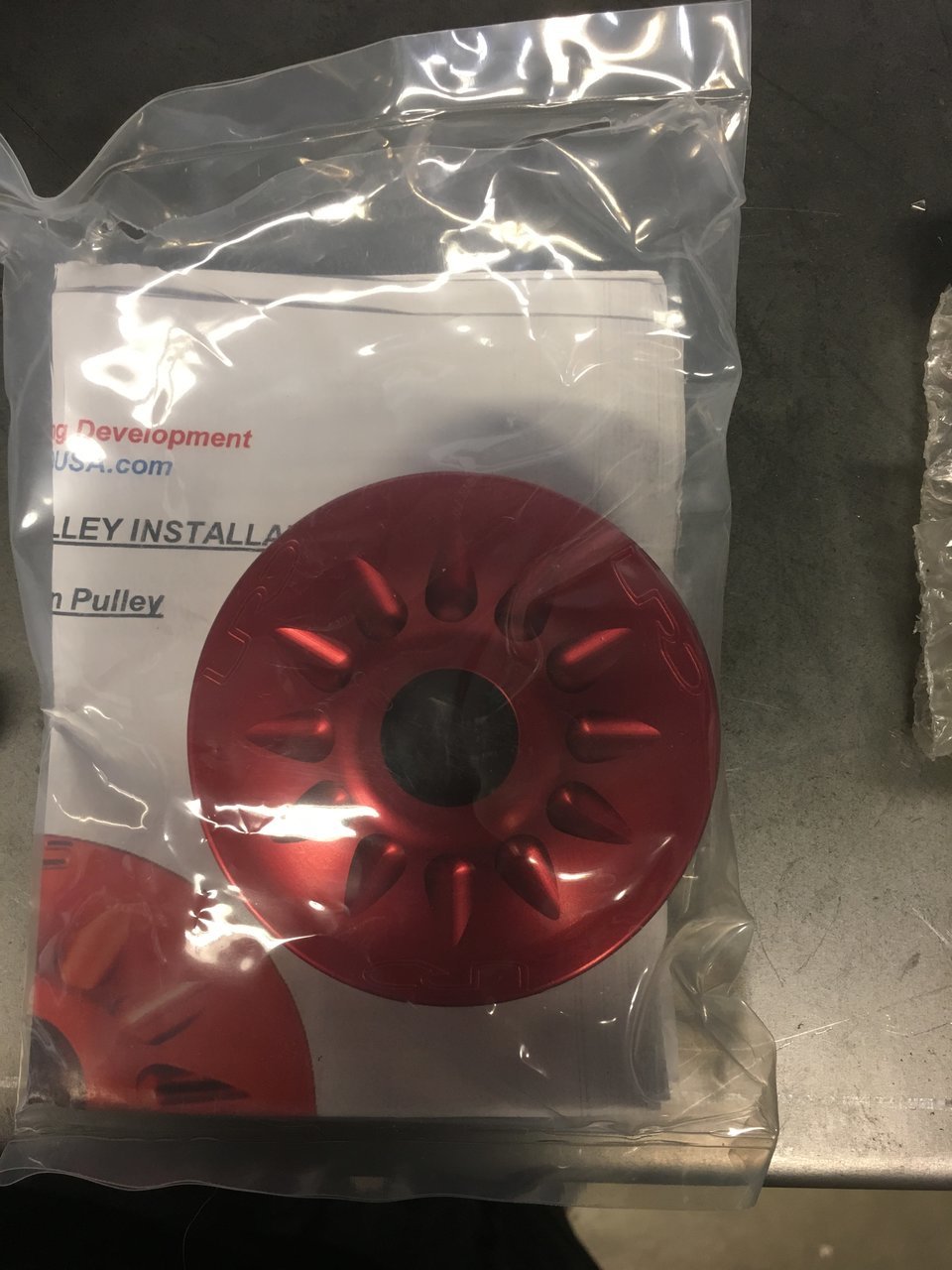

    URD 2.8 super grip pulley. Never installed. Only opened to confirm beauty and to take a couple of measurements. $80 shipped to anywhere UPS goes in the continental US.D1A4C002-CB06-4A0F-8AE1-CA6719F9AFA5.jpg
