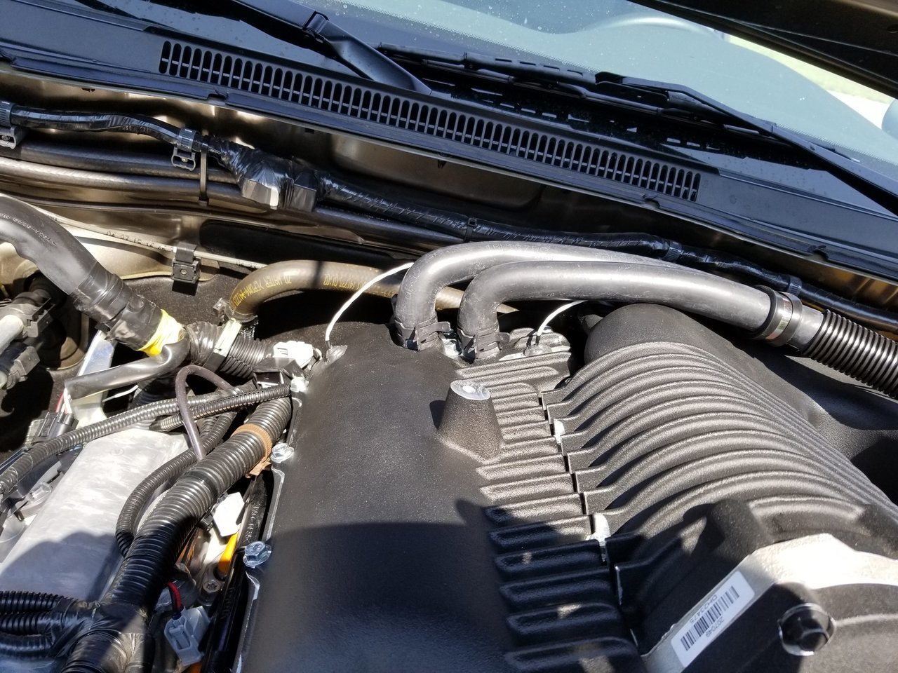

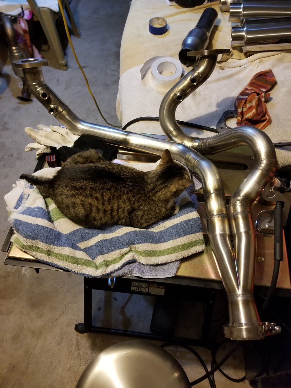

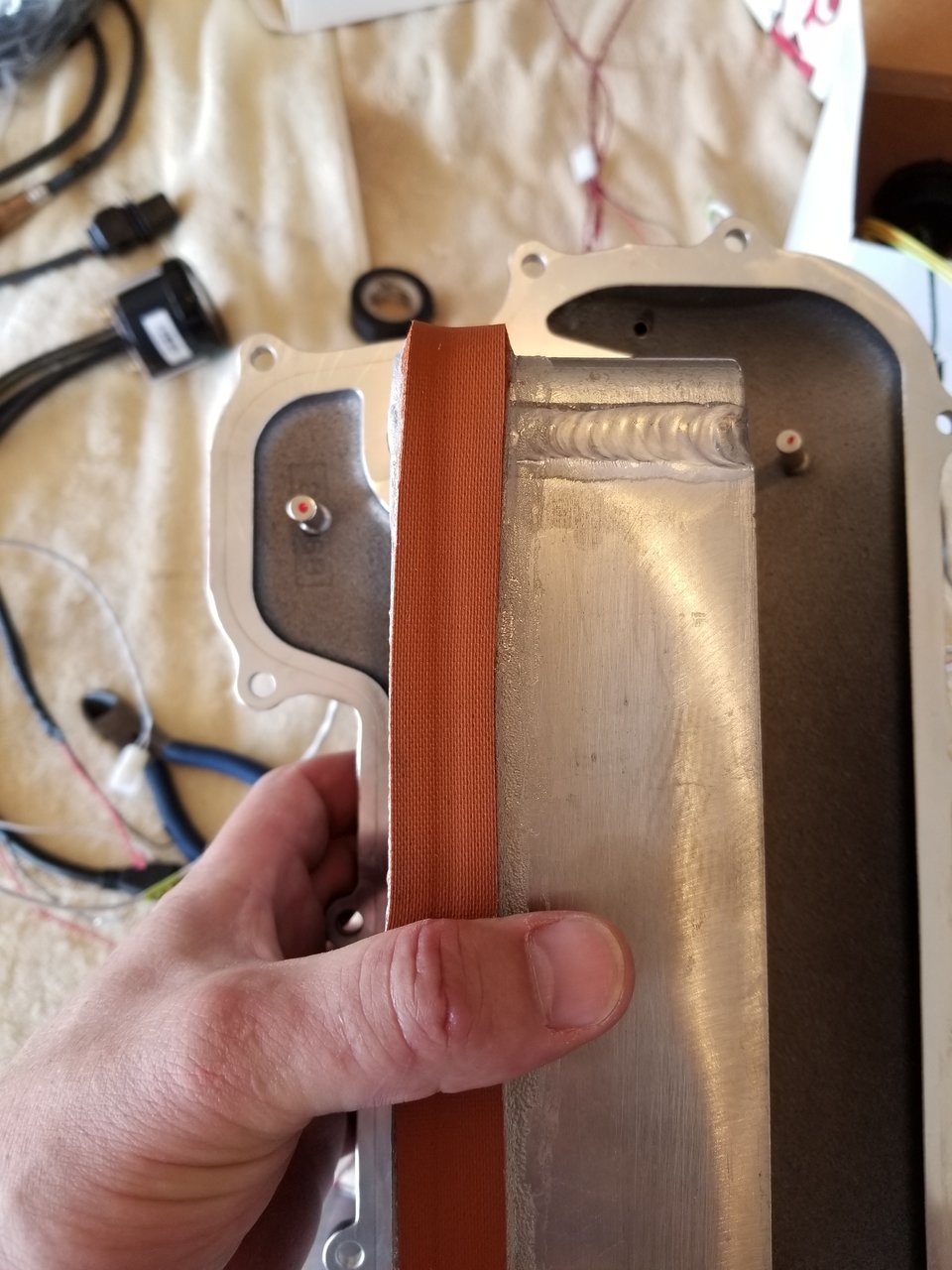

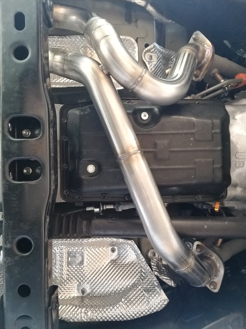

    I installed a pre and post intercooler temp sensor. When on the freeway cruising 75 the post ic temps are 20ish degrees over ambient. On a hard run from 0 to 90 the pre and post ic temp differential is 45ish.
    This is with UCON, 2.85 pulley, urd header, full custom exhaust, stock ic cooling system.20171104_181659.jpg 20170909_172300.jpg 20171103_202412.jpg 20171104_181659.jpg 20170909_172300.jpg 20171103_202412.jpg 20170910_120428.jpg

    Wow, nice gear, nice exhaust, nice data. So we are saying the intake air temperature is 20 degrees over ambient in freeway cruise. And on a full blast run the intercooler is reducing temp by 45 degrees. Three questions, what is the intake temp, post intercooler, on the full blast run? And what was the approximate air temperature outside at the time? Not sure if this data is recent (winter time) vs. hotter months. And what boost do you actually get with your system and elevation/temperatures?
    Do you have the ability to data log the coolant temperature with all of this? That would complete the picture of the intercooler and heat exchanger system, leaving little doubt about its room for keeping temps in check, at least with your boost levels.

    When I was really checking it out it was late summer. Post ic temps will rise slowly up to 30ish over ambient during a long incline. I will have to check it out more.
    My boost was 8.5 to 9 with just headers and stock y pipe but has dropped to 7 to 7.5 and much improved power with the equal length y and 3" tail section.
    I don't have any means of data logging it as it is a self contained system originally made for aircraft. Here is the link if anyone is interested.
    http://www.davtron.com/product-detail.php?M308-42
    Thanks for the complements!
